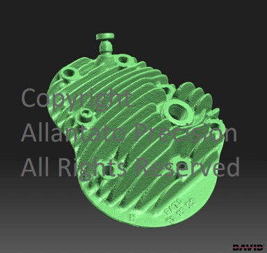

If they work for you then use them. Here is a 1929 Harley head I did a while ago:

i am impressed that you captured the heatsink structure up to the ground!
nice work! regards, spark
