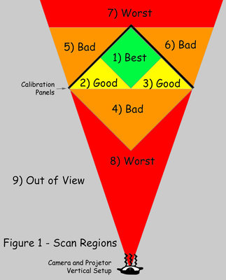

Re: Questions about David scanner sls-3
1. Scanning in HP3DScan is difficult because of some features used in this program. The system is extremely dependent on the accuracy of the 90 ° angle between the calibration panels (the RMS error value is shown in the program log and the smaller it is, the better (although personally, when I used this program, I never got less than 0.4 RMS)). But I only had homemade calibration tables.
This principle of calibration has one big plus - the "angle" calibration is very fast.
2. The size of the scanned object should be (ideally) commensurate with the applied table. The highest accuracy is obtained only in the central part of the frame (in the picture this place is shown in green). 3. Markers are not supported in this program. In the best case, you can put some additional marks on the object itself (or around it) - this helps to facilitate folding the scans into a single model.
4. The best result is obtained when using two cameras - they allow (up to a certain limit) to compensate for distortions and inaccuracies of calibration (but this does not apply to the "Extended" mode - there are just two "normal" scans)
