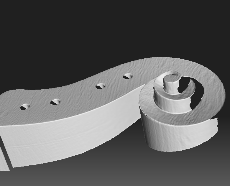

Hi to all.
Well, I'm surprised about the quality of the surface, even with a simple webcam.
It's also to say that my panel scale is 154 mm, so a little bit large for this scroll.
Looking forward to post more work, before going "serious" with IS camera!
Cheers
--edit
the "bump" on the right is a missing part, created in fusion.
volume is the result of 19 scans merged in fusion.
--re-edit
K132 is original, not modded yet. Good! I wonder what "laser" projector would perform.

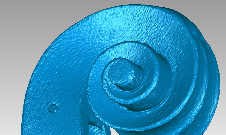

Although I already saw many posts in the past, I still did not find how to change projector refresh rate in decimals.
My card does not allow my to change this number in decimals: as soon as I save a 58.540 Hz, it save it as 59.
Images ar quite stable, with no bands moving up and down.
I can only see some flickering at the top of the sinewaves.
I tried with david 5, problem is less evident (I have a lot of dust coming from the used lens, that finished over the new sensor....) Although flat surfaces tends to have an irregular surface texture:
I have to admit that I'm impressed by the texture from monochrome:

Before you get ahead of yourself, do a series of scans at say 30º, align, and fuse them at a res of 1500 and a sharpness of 2 and see what you get. Don't go by a single scan. The surface finish you are getting is very good and a lot of those imperfections will smooth out during the fusing process. Post results if you can.
