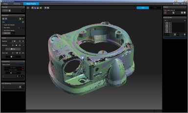

The alignment of the scans seems pretty good to me overall, but if I zoom into certain areas, I can see that it's not perfect. Here are the scans:

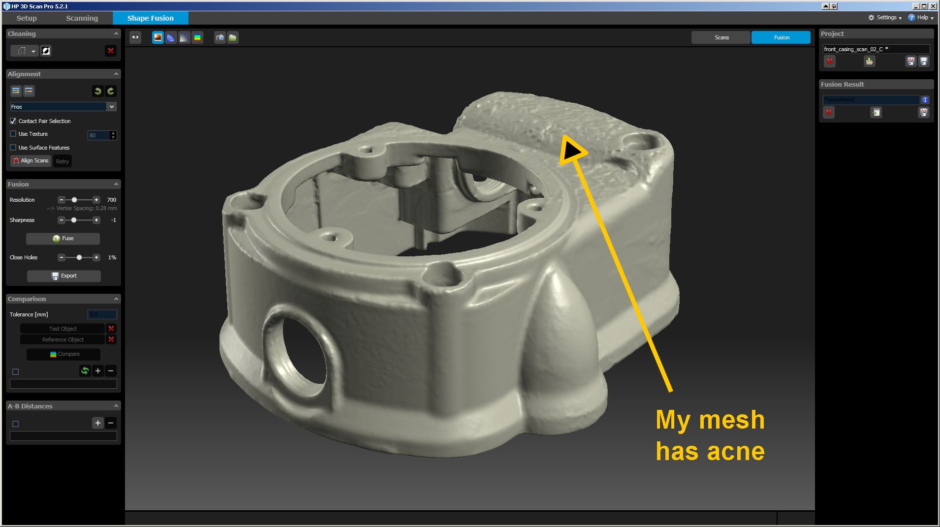

Here is the fused mesh:
The object's outer surface is very smooth, but the fused mesh has noise on the surface that looks like it's made of cast iron. The area with the heavy rough surface is the region where the scans are slightly above one another.
Does anyone have any tips on what to try to get a smoother surface for this object or does the gloss black color make this the best I can get?
