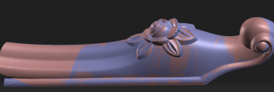

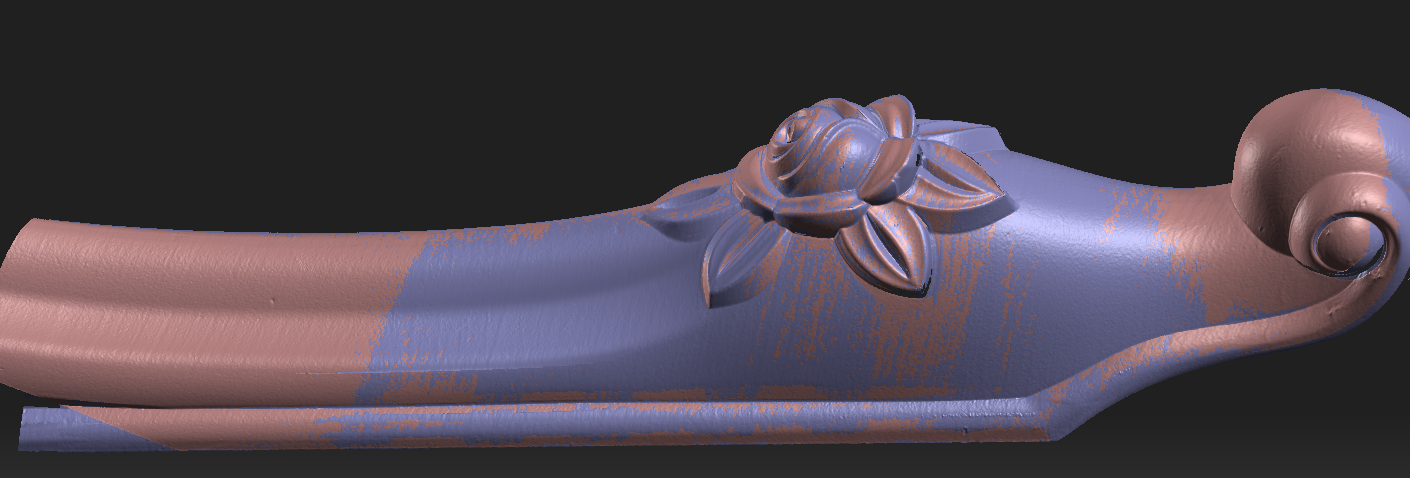

another example, when you scan the same object from different angles, the scans start to diverge at extemeties, here's another example,only 2 scans. I'm starting to think David is a waste of time and money.
Do you get the same effect or my equipment and settings maybe not optimized?

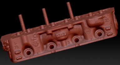

Carefully when you say " I'm starting to think David is a waste of time and money". A loot of people are making amazing things with DAVID for professional work as well (seescanprint3d of facebook).
Can you show the setup you are using and what hardware?

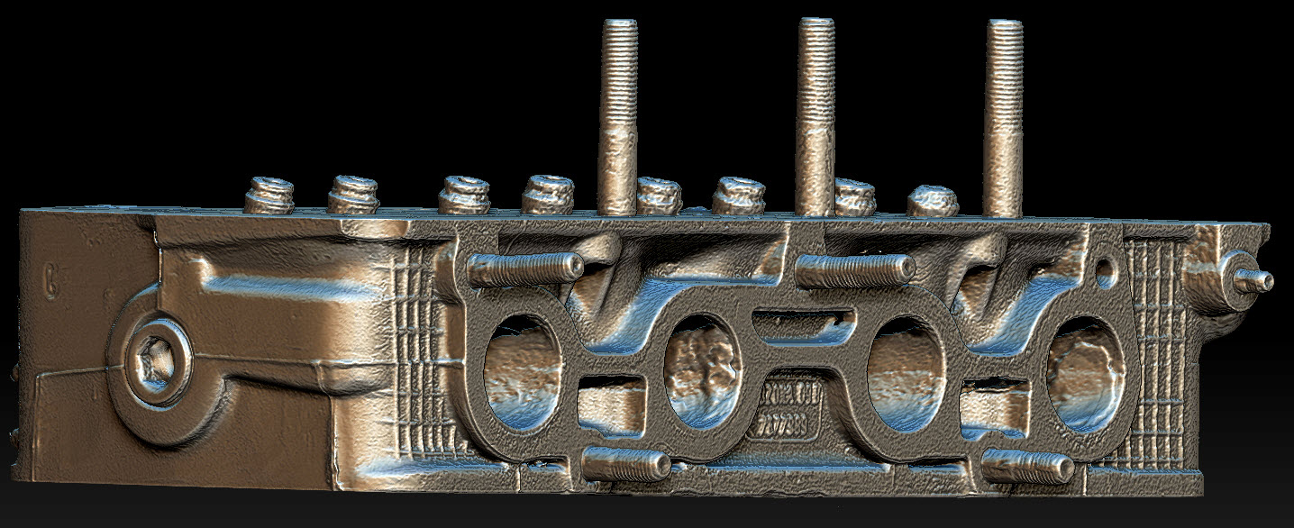

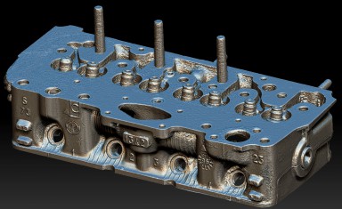

To show what DAVID do I'm attaching some pic.
3dxcan
Posts: 74
Joined: 02 Jun 2017, 17:21
Re: Alignment problems
Post by 3dxcan »
erapip wrote: 11 Aug 2017, 07:55 Carefully when you say " I'm starting to think David is a waste of time and money". A loot of people are making amazing things with DAVID for professional work as well (seescanprint3d of facebook).

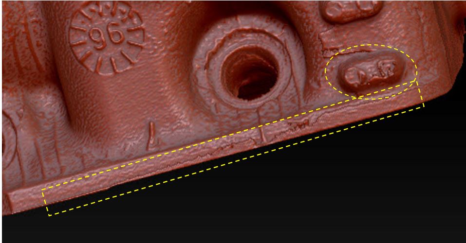

your scans arent aligning and merging fine either, see this picture, your casting part is too rough to show were the each shot is merging to the other, but still you can see them not merging accurately here:

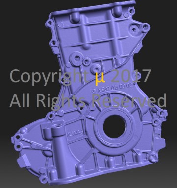

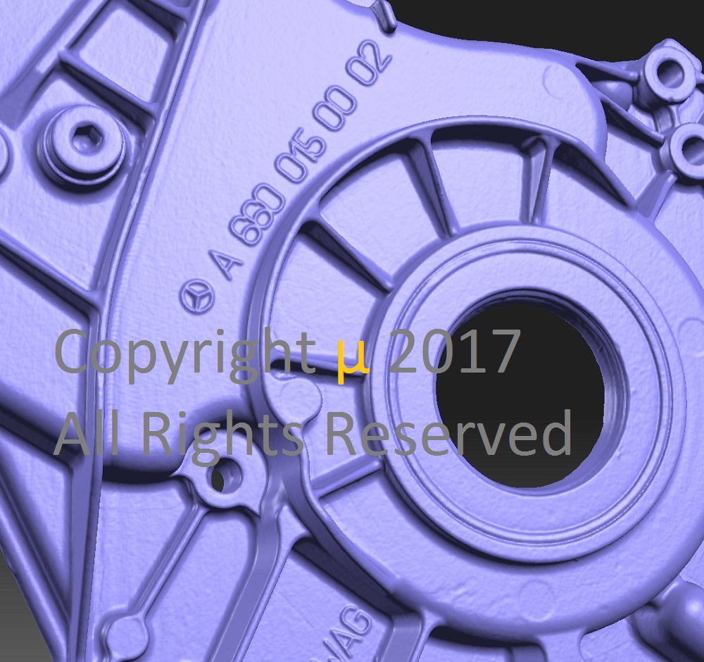

Don't forget "Good, Fast, Cheap. Pick two." David is good and Cheap. It would be faster if you spent more $ and bought a preconfigured system. Even still there is a learning curve that you wouldn't have if you spent $30k of an Artc or Creaform. Part of the learning curve is getting it to do what you want to do with the support of a company you just gave a small boat load of $ assigning an engineer to help you configure/train.
Not that david isn't worth it, but (and I've said this before) getting what I call engineering level results out of hobby priced set up takes a lot of work on your part. I can personally attest that is possible. For me it took literally years of experimenting (I've been using David for nearly 5 years now, it still takes time each time I use it to carefully set up. Even then it sometimes gives me problems I have to solve. the difference is that the more I use and refine my process the faster I get. I also have a fairly good feeling of what Davids limitations are. I've looked at and used a number of scanners and understand that the major difference is the amount of engineering and refinement each system has. understand that that also clearly reflected in the price of the system.
3dxan: You need to spend some time experimenting if this is something you want to get good at. knowing the theory helps and I'll try to answer any questions I can. Also know that part of the years of experimentation I did was also research in the equipment and all the variables there. I spent literally months just learning about lenses and getting demo lenses from manufacturers. I even went so far to have a phone conversation with an engineer at Richo (in South korea) about the MTF profiles of various classes of their lenses. I mention this because all of these variables can play a pert in what you are doing. My instinct however is telling me that the miss alignment is coming from data that is captured outside of the optimal scan envelope. david's error rejection, correction and smoothing isn't the most sophisticated. I am also assuming that your calibration and calibration equipment is spot on. If not, there could be another source of your problem.

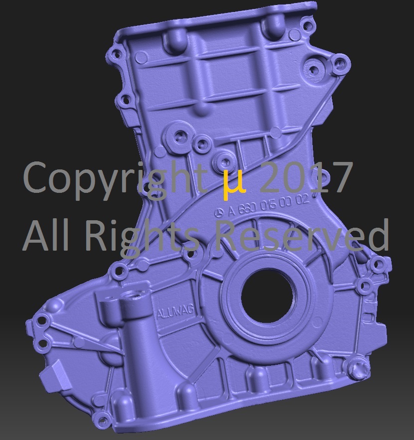

P.S. This is possible:
