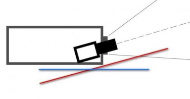

Thanks for unscrewing your projector for me.
This is strange because the rear thread distance is not the same height as the rear leg. So the angle of the projector is different than during measurements (the projector looks higher than it would stand on both legs).
I`m confused more now.
Have you built your rig alone? Have you some 3d/CAD template for this?

Could you tell me how you calculate the projector angle
and what angle you use for LG HF60LS? Do you use also 10.65 degrees angle or have you calculated other value for that scanner?

but without that, you can`t be sure that the angle between the camera direction and the line from the centre of the projector lens to the middle of thrown screen height will be parallel.
It should be that (maybe I`m wrong):
When you set angle randomly only to meet thrown screen centre and camera centre:
I`m wondering if that angle 10.65 is important or not because after looking at your setup and your last post I see that you only meet the projector and camera centre on some random angle (only to meet both in one place). Do you use ScanCenter on that setup?

It could mean that perfect coincidence between cameras and projector lenses is not necessary. Because after the manual change you can't be sure what angle you really have. I`m trying to get that perfect 10.65 angles. When I need the camera to look higher then I give some small pads to screws without changing the vertical angle. I`ve thought that keeping that 10.65 angle is crucial but maybe I think about it too much.
I`ve written an e-mail to LG support to get from them factory vertical angle. I don`t think they will give me but it is always worth trying.
Thanks for trying to help me.
I`m not sure which angles are really important and which are not. It looks the perfect vertical coincidence between cameras and projector lenses is not so crucial here.
Without coincidence, I had an accuracy about 5mm per 1.5m. With almost perfect coincidence to that angle 10.65 (I had 10.62), I had an accuracy about 3mm per 1.5m but the reason for that may lay somewhere else.
Always then I see that projector angle or camera angle is regulated on screws it means for me that setting perfect angle is not so important (you can't measure what angle you have actually.
