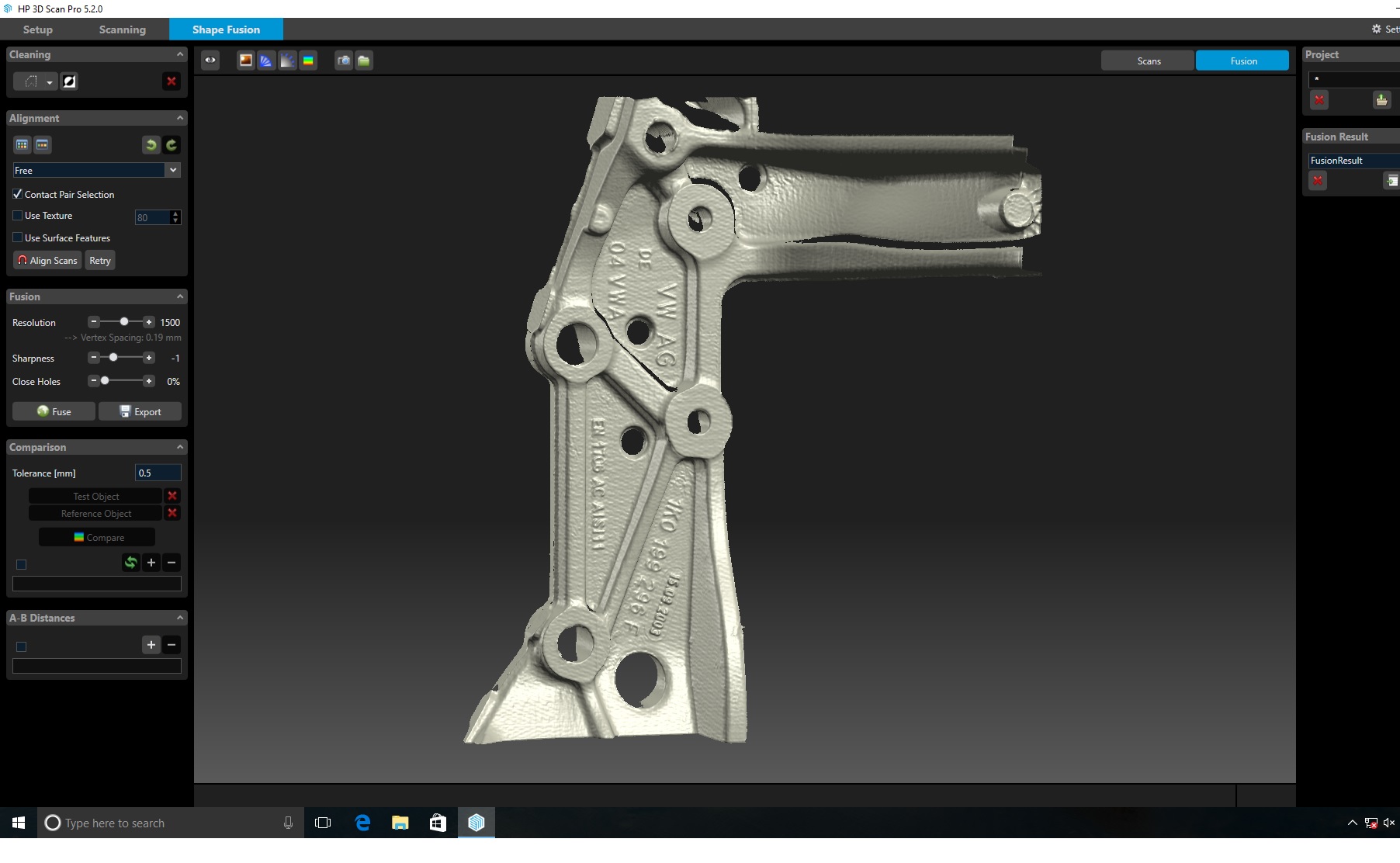

I think that ONE of the most important case for good alignment is also the SETUP. I tested different projection angle and with "Total triangulation angle" 19.18° i had lines in the scan. Recalibrate with "Total triangulation angle" 23.89° and the lines disappear. Also the alignment look better.
I would say that Diagonal Setup gives nice scan details than only Horizontal. Correct me if im wrong!

thats seems like a nice scan, however you can see your shots are not aligned well as you see single colors on most of the scanned voulme. the scans are not blended together, which shows alignment needs to be better. also in your fused result, borders of each shot is visible. that means scans are misaligned.
Is it a David SLS or a custom setup?
BTW, thanks for notifying about the new release. I'll try to install.
I see what you mean, but the parts of the scan that are aligning are aligning quite well. The holes in the bosses look properly round etc. I think if he slightly increased the error rejection and or the outlier filtering that would improve. I have found that the distortion like this in most scans is not linear. So, the center of the scan may actually be relatively accurate. Trim away the sub optimal edges and you can clean up the final result.
What do you mean by diagonal set up? Do you have you cameras above and below the projector but offset to either side too? I have been using a side by side set up mostly for convenience but have previously found that calibration is easier with a vertical camera placement. Again one of the reasons I wish David would rethink the calibration procedure.
It really depends what you compare the results with. If you compare david with david, yes its pretty acceptable. But if you compare it to professional scanners, the alignment Is off.
You dont see such problems highlighted above in their results.
It is about comparing the final mesh to the real world subject. I have done this by comparing the measurements from the scan to CMM measurement data and found my scans in David to consistently be in the ~.05% range for accuracy. That accuracy seems to decreases exponentially the further you get away from the point at which the camera and projector were focused.
