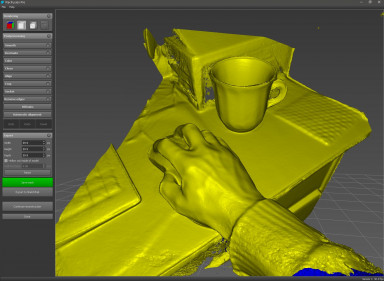

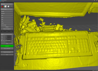

And here is only the "competition" of Depth camera scanners:
Kinect with 2Gb videomemory (he no longer needs)
Realsense with 2Gb videomemory

Initially, my old GTX660 graphics card lacked 2GB of on-board video memory (the program uses the GPU and its memory with might and main) to run it at settings above average. As a result, I installed a modern video card GTX1660 with 6GB of memory on board. It was possible to raise the resolution of the “depth” part of the module to 704 voxels (the scanning speed also increased and became smoother due to the higher fps).
And, of course, a scan on D415 after replacing a video card with an increased number of "brains" :D :
Realsense with 6Gb videomemory
