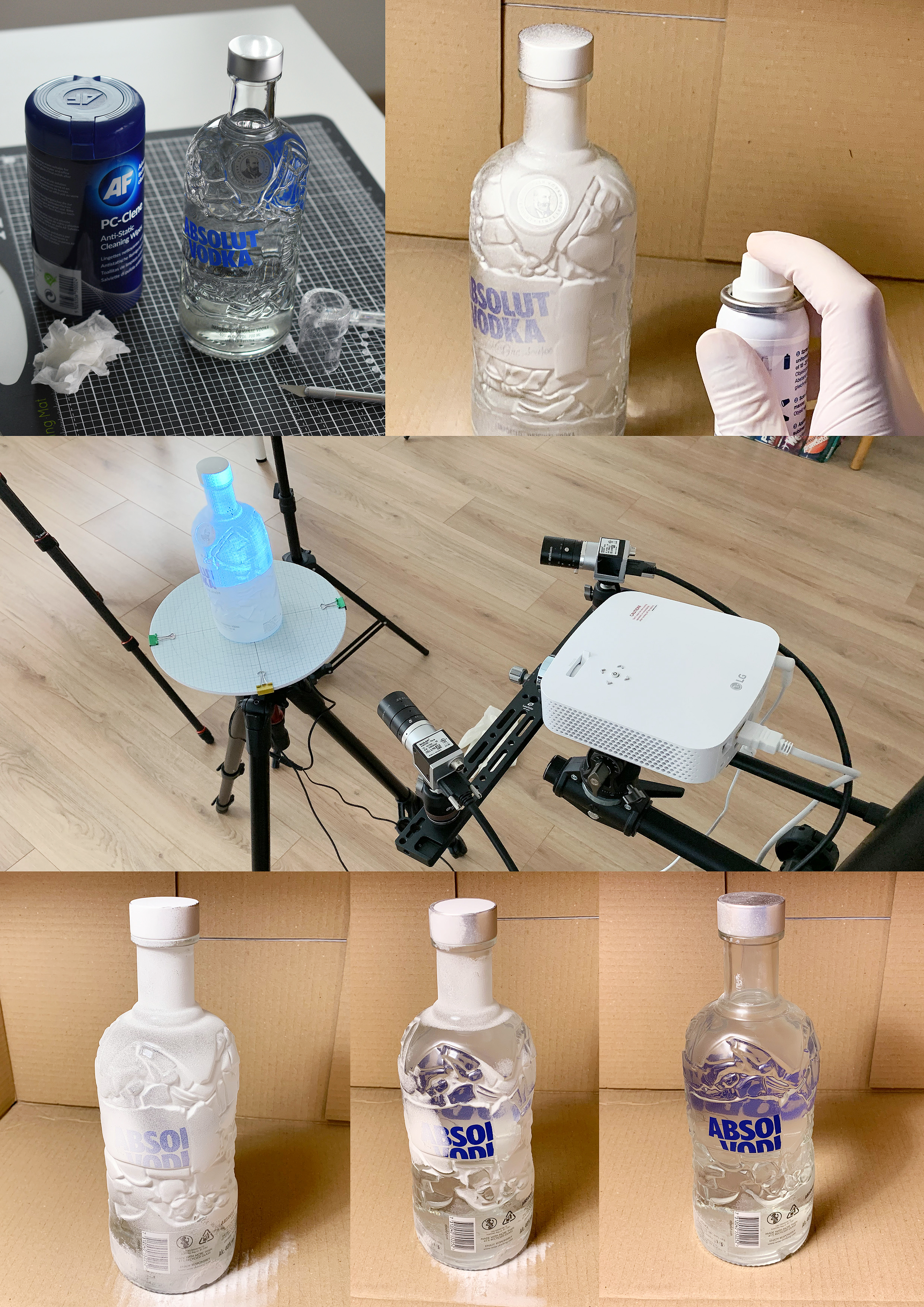

Hello,
I wanted to try 3d scanning with the Aesub sublimation spray for glass and shiny surfaces.
I used FlexScan3d for the scanning, Zbrush for editing, Substance Painter for texturing and Blender for rendering the model.
The spray works well. After vanishing it left some dusty spots on the bottle, but the cleaning was much easier than washing off white paint.
Backstage
Backstage
Clay and Final render of the 3d bottle
Views of the scanned object

great job.
would you mind to present your setup and scanning strategy?

Nice scans. Thanks
Which LG projector is that? Is it modified?
