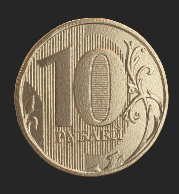

And another my "popular" model - scanned coin 10 rubles :D
Scanned coin 10 rubles

Did you scanned flat on the turntable?
Re: Some of my scans
mading wrote: 05 Mar 2021, 18:04 Did you scanned flat on the turntable?
Yes, the coin was lying on the turntable, each side was scanned at an angle (to capture the end surface too), after which the two groups of scans were manually aligned.

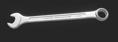

A couple of my last scans - a wrench
Preview picture
Preview picture
View the model in 3D

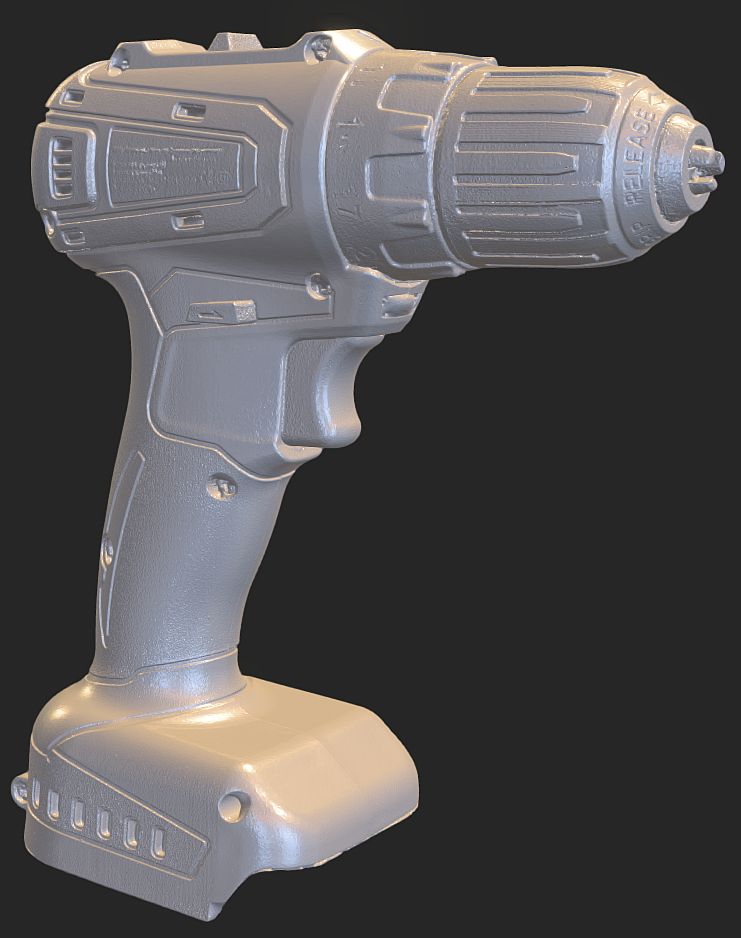

and screwdriver (this model has "flaws" due to the fact that the spindle turned a little during the scanning process)
Pic. 1
Pic. 1
Pic. 2
Pic. 2
To place these models on the site, the scans had to be simplified to 3% of the original number of triangles.

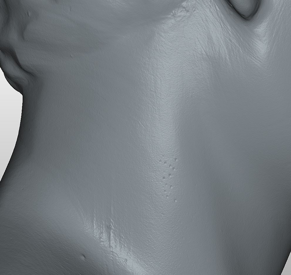

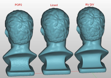

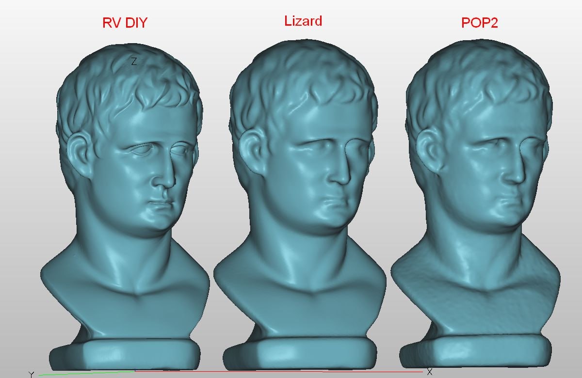

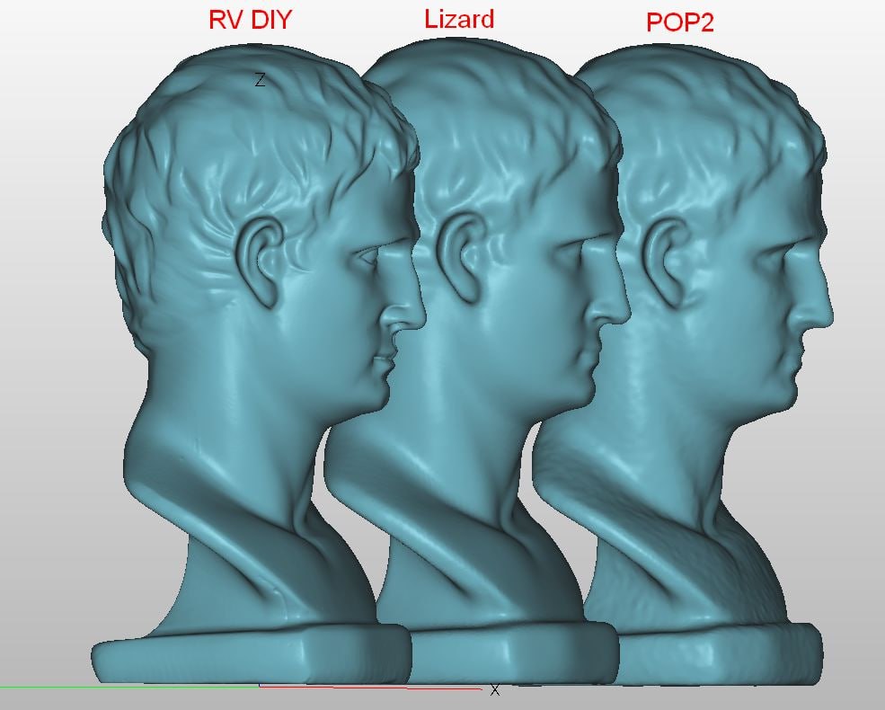

During the New Year holidays, I received a Revopont POP2 for a while, and decided to conduct a small comparative test with my Creality Lizard (which was half the price of POP2) and, as a kind of "starting point", a scan on my stationary SLS scanner. The plastic bust (height about 10cm) that came with POP2 was used as a test subject.
At first, I did not see any strong difference between Lizard and POP2...

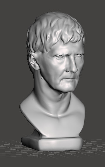

But then it turned out that if I finalized the scan in RevoScan (and would not switch to RevoStudio later), then the quality of POP2 is noticeably higher, although there is still some "noise"

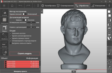

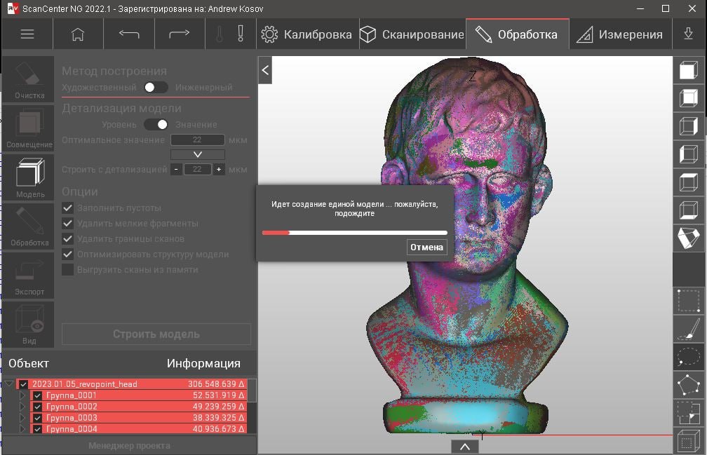

Also scan from RV DIY
Its surface detail, of course, cannot be compared with cheap hand-held scanners based on IR illumination.
P.S. A little later, in the RV DIY software, I combined a scan of myself (made with Lizard) with an existing sculpture from Revopoint :mrgreen:

Thanks for sharing!

Thanks for sharing. I got a revo mini, and it's OK for some things. But I plan on refining my SL rig soon, but the mini is no replacement.
