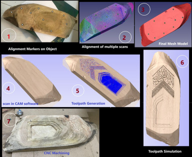

One of my projects that I did recently with Modified Flexscan3D by greenskynet.
This is my second scan and i keep improving with the support of telegram community especially the guy who is the author of advanced modified Flexscan3d

Nice. What cam app? The artwork just vector graphic from illustrator, or something similar?

I m using Vectric Aspire and the Artwork is simple vectors that i converted from image using Vector Magic.
