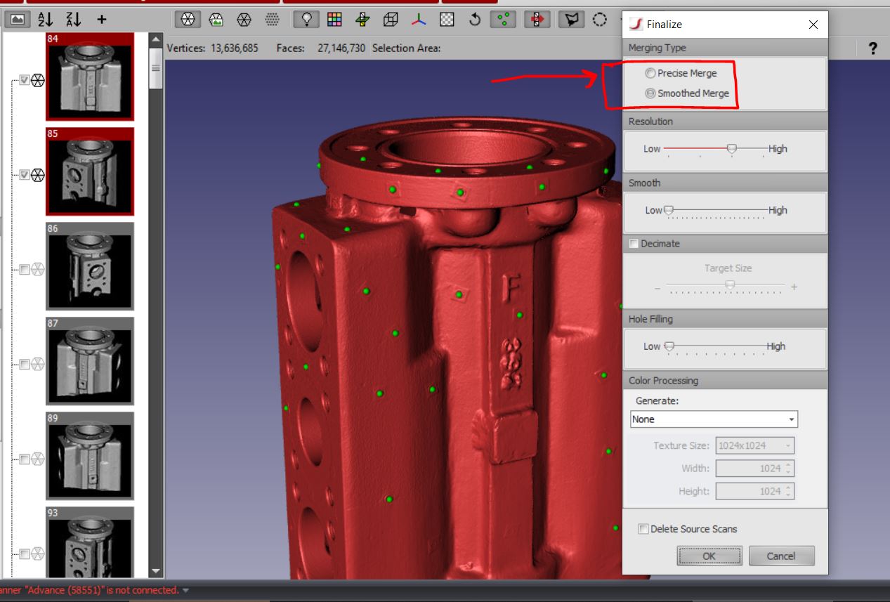

For Example, in FlexScan3D software, there is two type for Merging: Smooth and Precise. The Smooth method slightly deform the mesh and try to yield the best surface quality on the final mesh, suitable for Art subjects. The Precise method try to keep the accuracy on the geometry at the highest level, suitable for engineering tasks.

This is Merging of the FlexScan3D. You can select two modes, for accurate or nice appearance scans.
