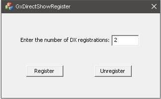

I installed it and the software has not been able to see my cameras, although I can see them with the SDK software of the Dehang Cameras.. Win7 and Win 10.

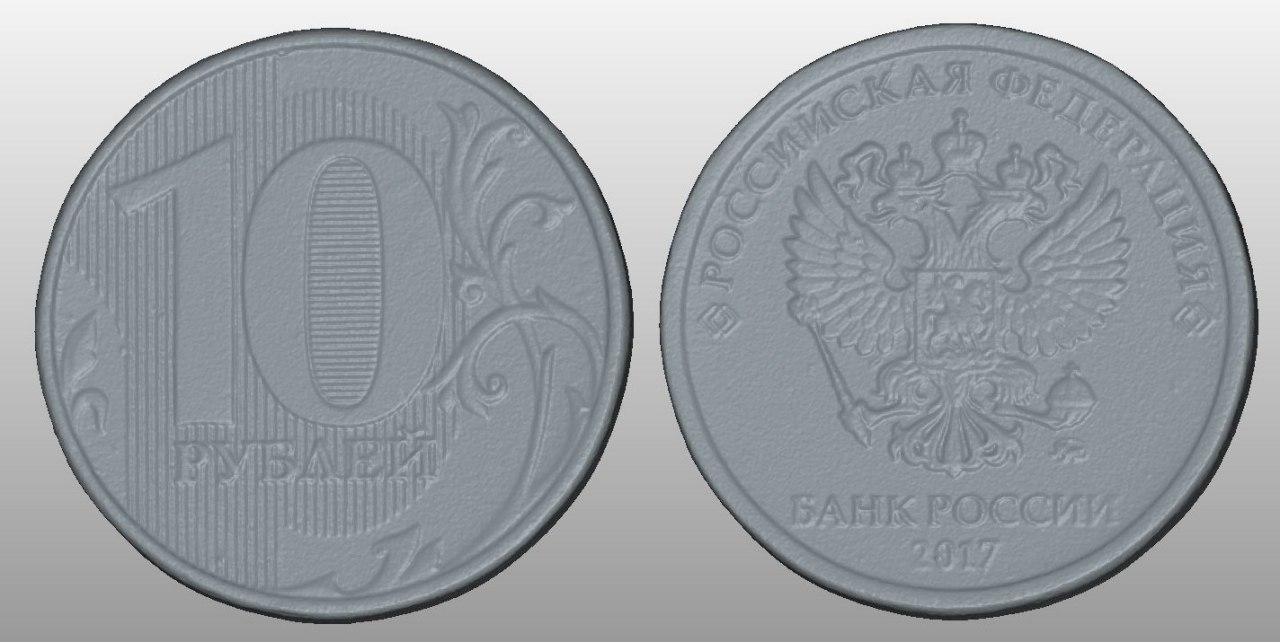

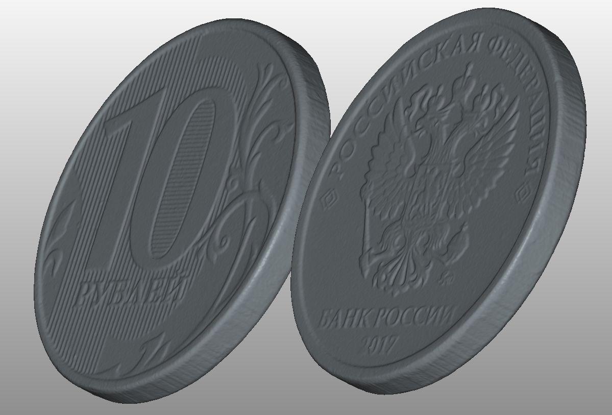

One of the last scans made on a homemade 4th zone (not included in the delivery set). An old HD projector was also used, because it can focus at a much shorter distance (and thanks to the higher projection ratio from 150mm, it provides almost better pixel density than the new FullHD projector from a distance of just over 300mm)
Still, it turns out a little "softer" than it was when working with HP3DScan
Download the model(55mb stl) can here
Important! For work in the 3rd zone, a lens with a focal length of 16mm is optimal, for the 4th zone the program asks for a 25mm lens - but, with some tweaks, you can use the same 16mm. But on the 1st (~ 300mm) and 2nd (~ 150mm) zones, I have not tried to scan anything yet (for them, 12.5mm (12mm) lenses are recommended).

kilrabit wrote: 05 Oct 2020, 12:07 I installed it and the software has not been able to see my cameras, although I can see them with the SDK software of the Dehang Cameras.. Win7 and Win 10.
Have you only installed drivers on cameras?
I, in addition, put Galaxy DirectX SDK
After installing it, I ran GxDirectShowRegister from this folder, and in that field indicated to register TWO DirectShow devices
