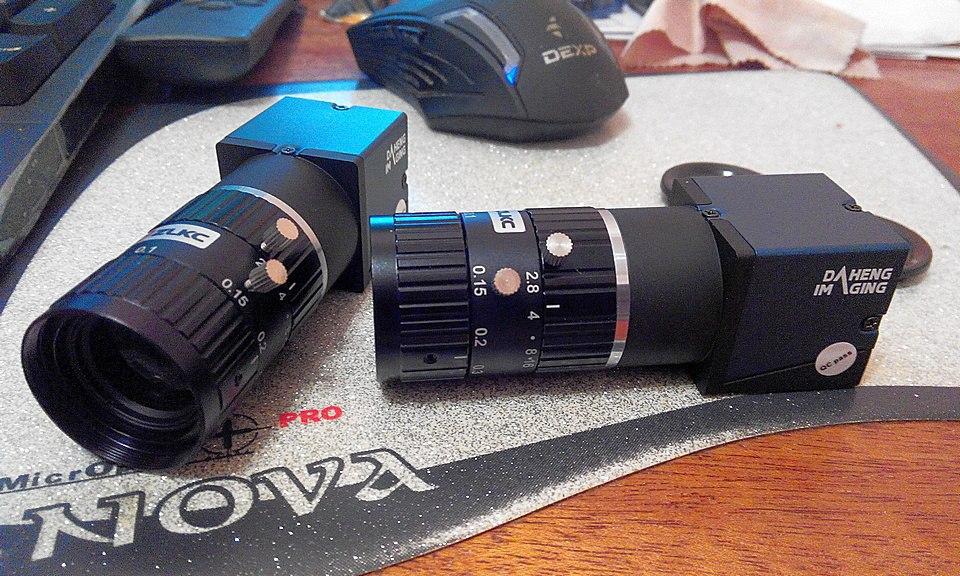

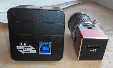

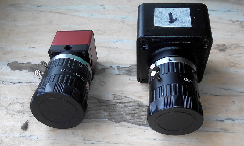

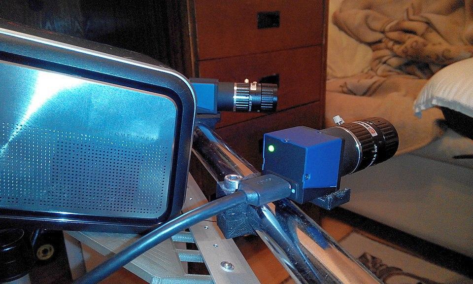

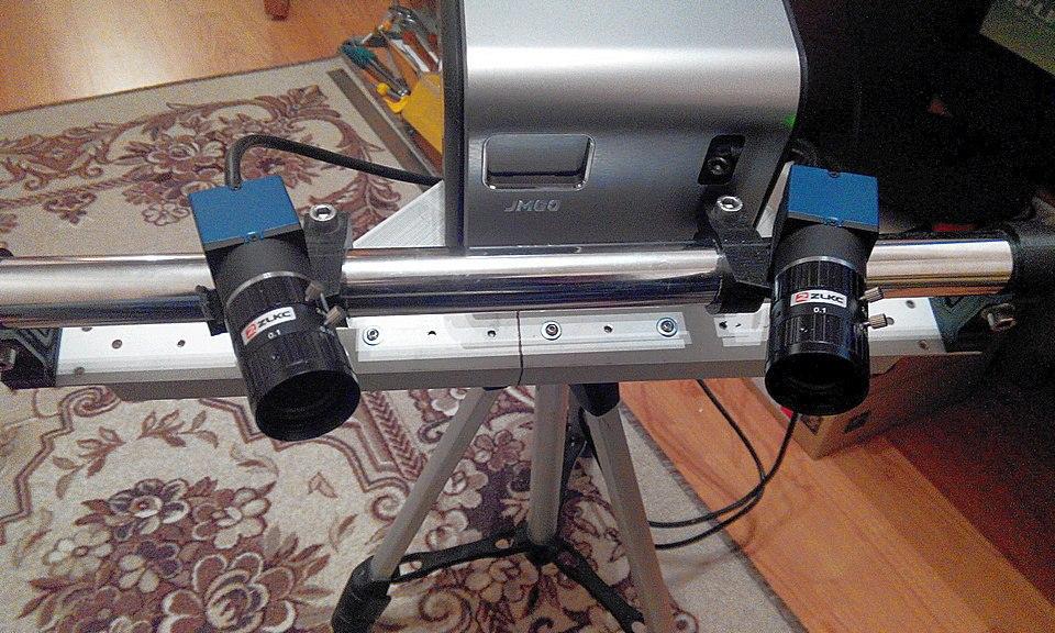

As a result of all the changes that have occurred in recent months, I got a completely new scanner (instead of Mindvision SUA630-M cameras, Daheng MER-630-60U3M-L cameras similar in sensor type (IMX178) were purchased). Also, since previous cameras were sold with lenses, new 10MP 16mm F2.8 lenses were purchased (although they are "darker" than the previous 5MP 12mm F1.4). The projector was also replaced with a FullHD JmGO J6S with an honest FullHD matrix of 0.47 "DMD (however, this is not exactly what I wanted ... I just could not find (or did not have time to buy on sales sites) LG PF1500, which has the most suitable form - factor, with the same 0.47 "matrix)
Of course, all this was not done just like that, but was required for the transition to the new RangeVision ScanCenter software.
- New cameras with new lenses
- While the setup looks like this - 1
- While the setup looks like this - 2

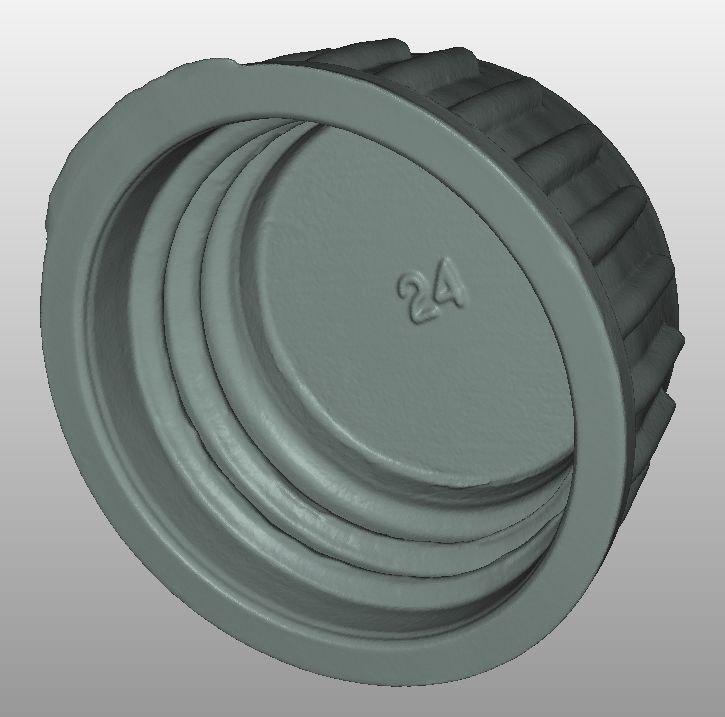

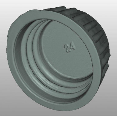

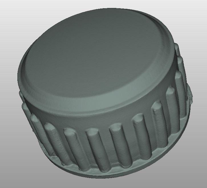

The diameter of the lid is about 20mm (it was scanned on an automatic rotary table controlled by the program. And almost everything turned out by itself, it took only a small manual "intervention" when connecting the scan of the outer and inner surfaces)

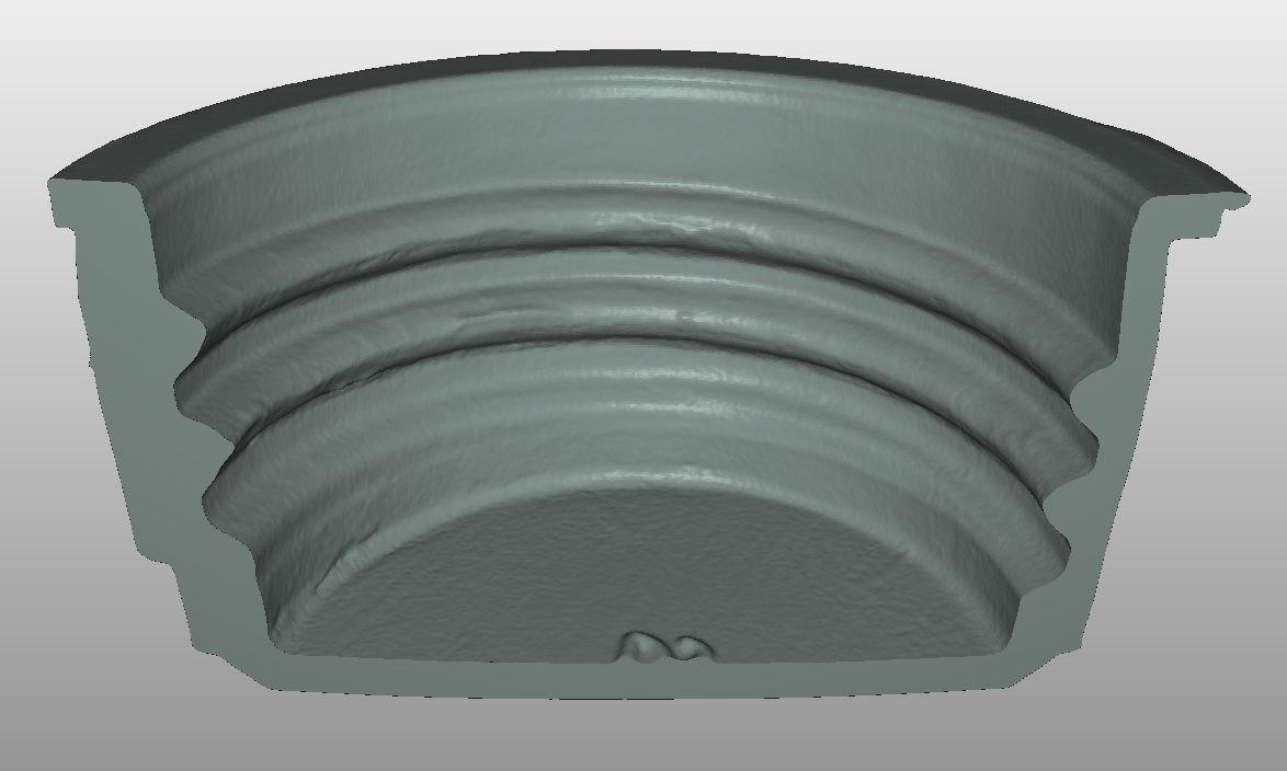

The section was also performed in the scanning software.
- Small vial cap - 1
- Small vial cap - 2
- Small vial cap - section

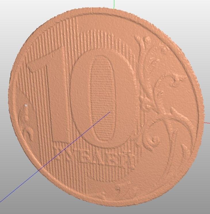

So far, the coin dough is not very good (in this program it is necessary that the cameras are much closer than I can put now (the angle between the cameras is only recommended 20 °))
- Coin (not as good as you want)
