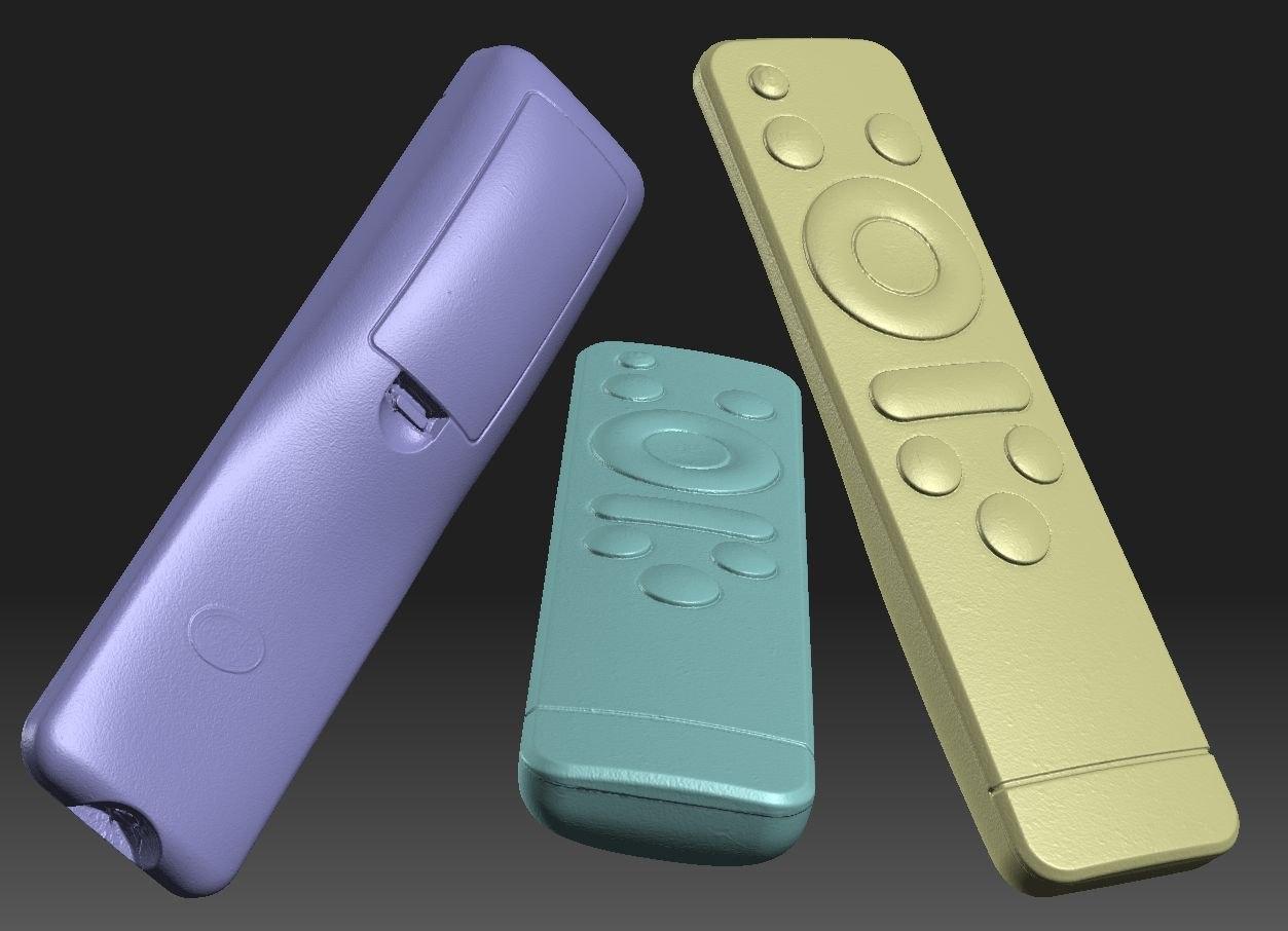

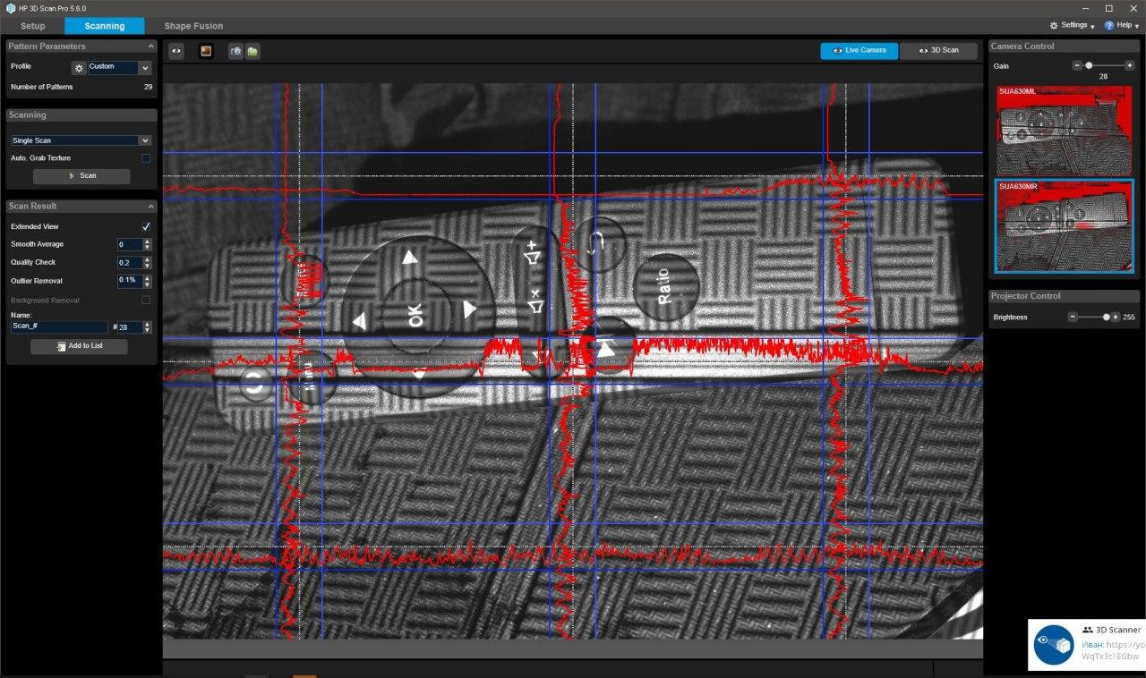

I once scanned this remote control from the projector, but then there were other cameras that, although they could capture fairly black objects, made it much worse than new ones (although it is not very easy for new ones). In addition, there were previously problems with the final mix.
An 80mm calibration chart was used and many, many scans (both in composite mode and (some individual views) in advanced)
The appearance of the remote control, as cameras saw it.
After finalization
After finalization
P.S. I did not upload the finished STL file, because it turned out to be 250 MB in size

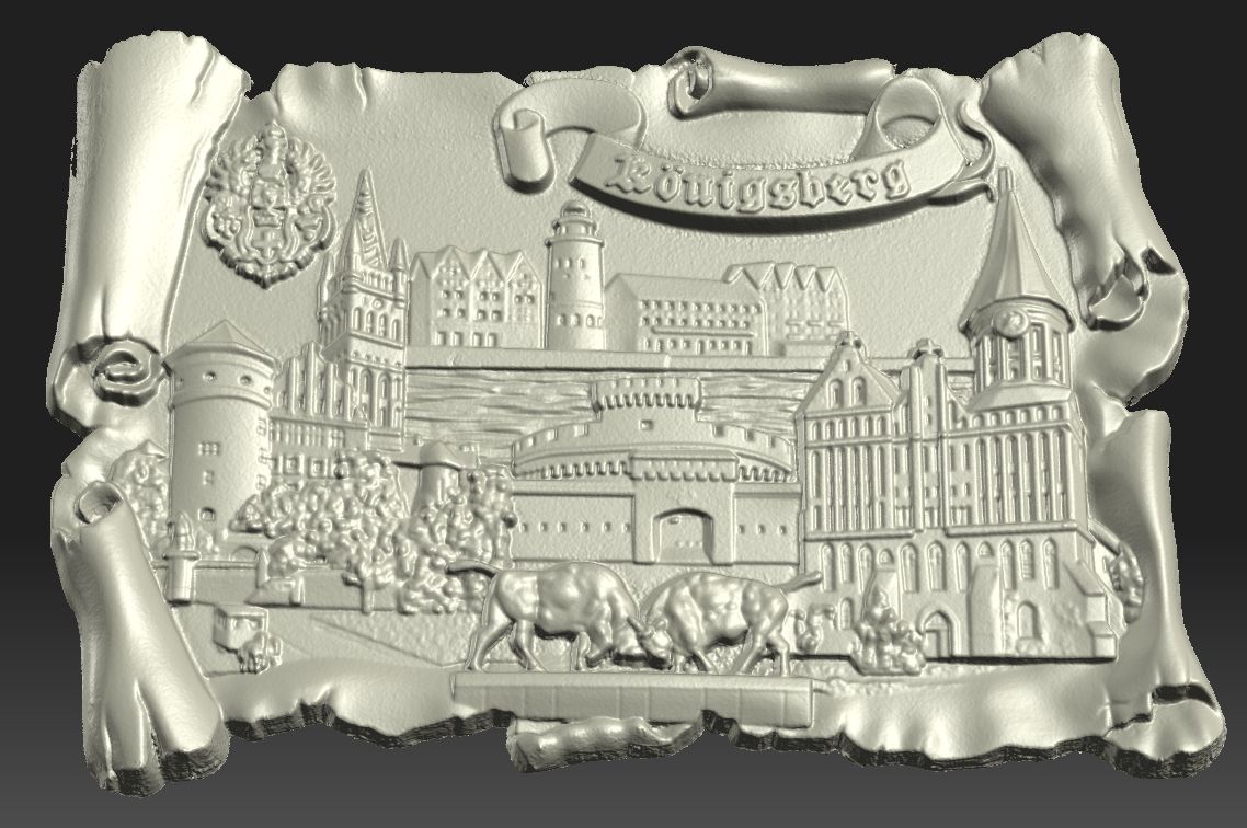

I also post updated fresh scans:
Fridge magnet
Fridge magnet

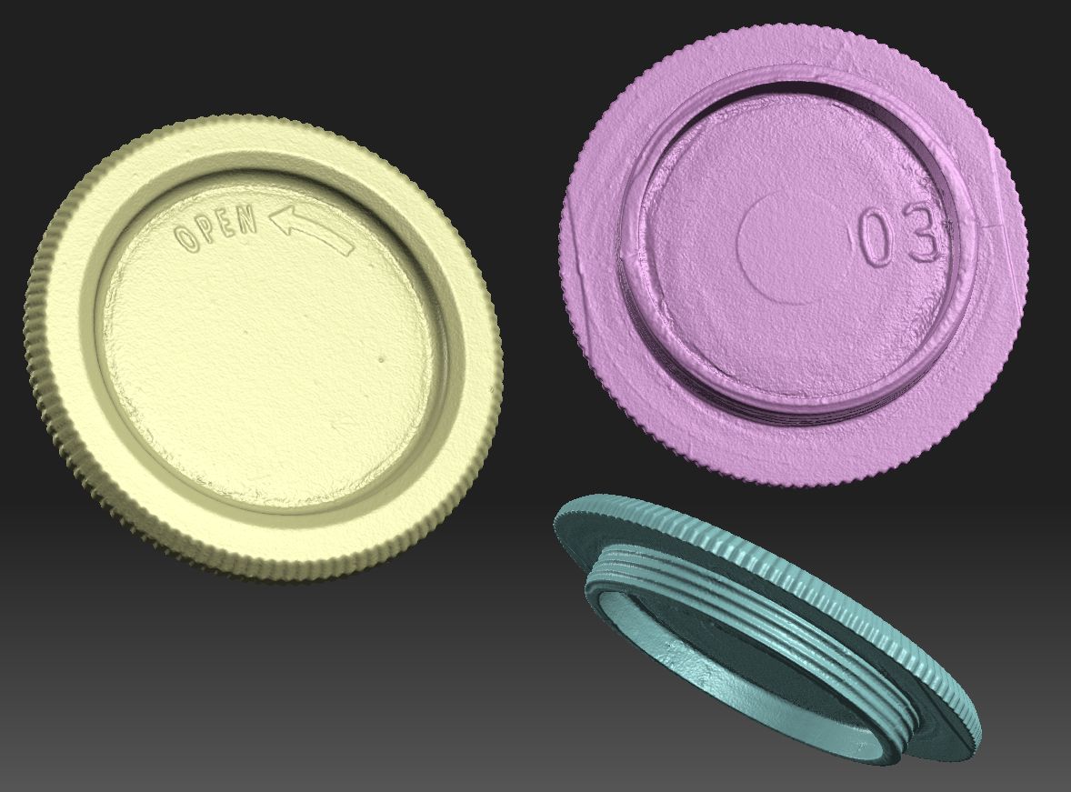

A protective cover from one of my cameras

Excellent! You really have your system dialed in well.

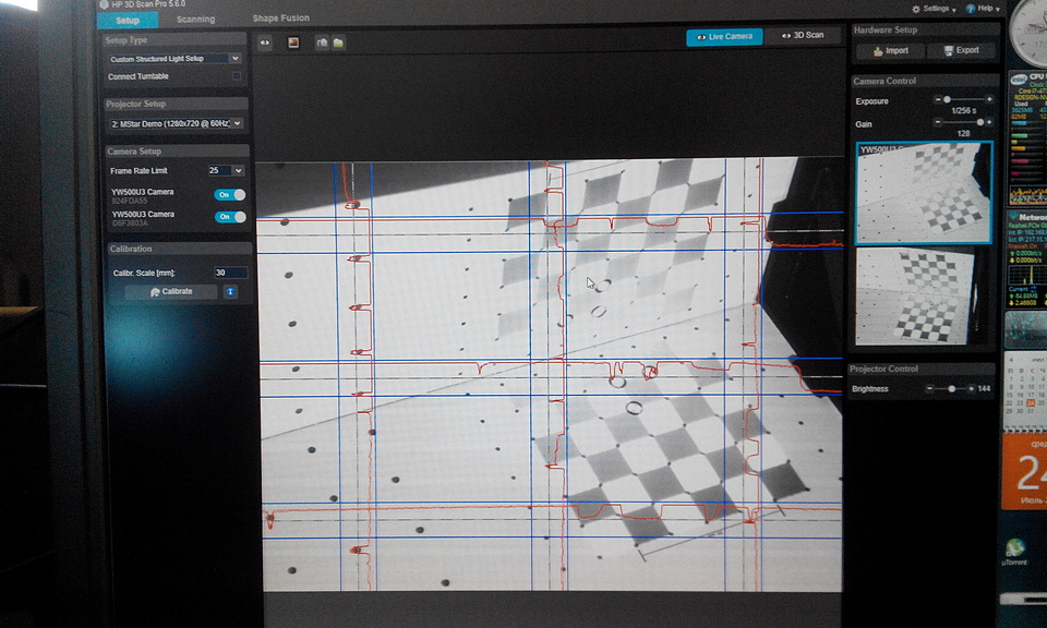

kth307000 wrote: 17 Jul 2020, 15:42 I'm curious how you set it up.
I can't align properly due to distortion after scanning for any problems during the calibration process.
For scanning very small objects, I usually try to use my smallest calibration table - 30mm. But lately it has become quite good after calibration according to the 50mm table (it is easier to tune in here).
You can also try putting the calibration panel on its side - this greatly simplifies the calibration process, but the model will be rotated 90° in the program (which will require you to rotate everything after scanning to a convenient position for perception).
This is also a great calibration.

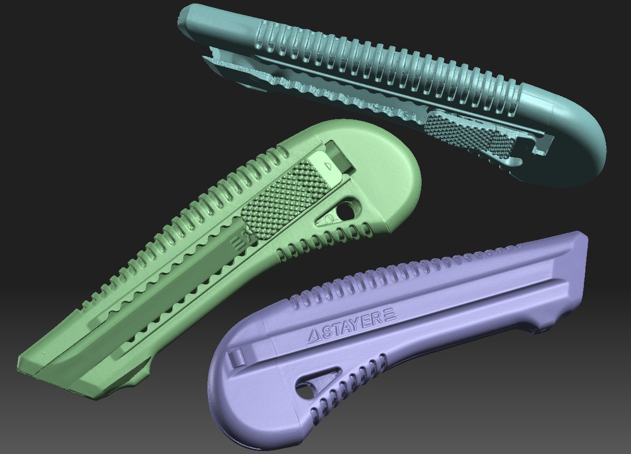

Scan of the handle of a conventional segment knife - 1
Scan of the handle of a conventional segment knife - 2

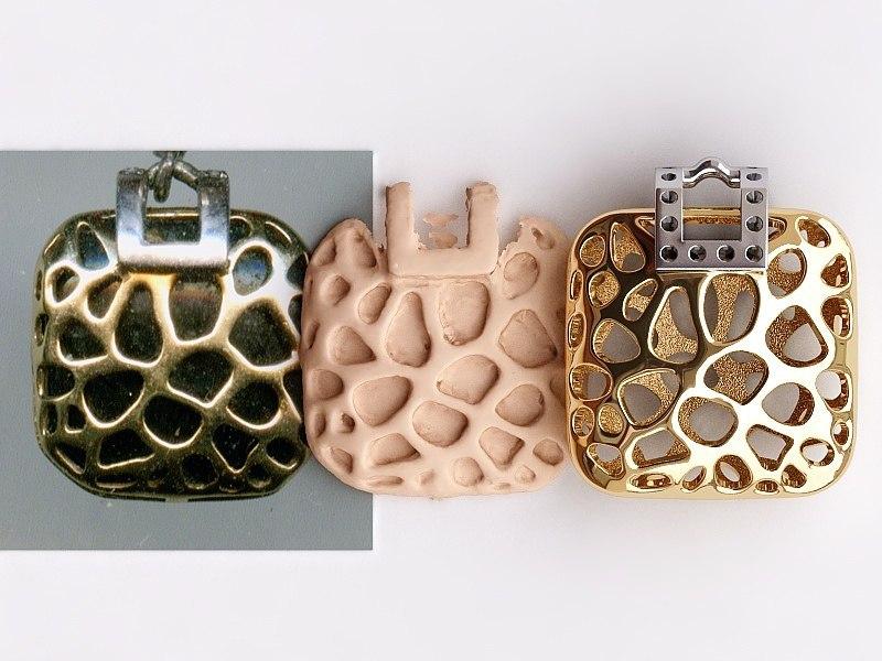

Creating a "replica" according to the existing sample - 1

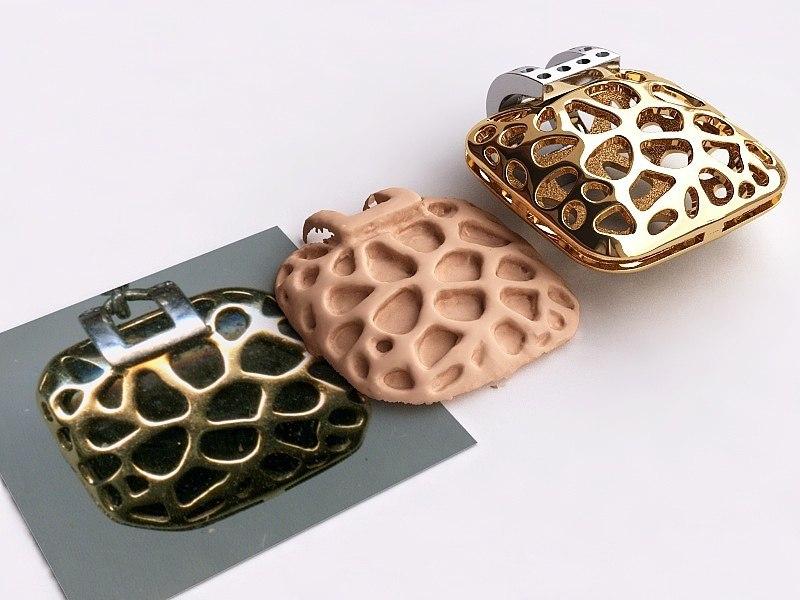

Creating a "replica" according to the existing sample - 2

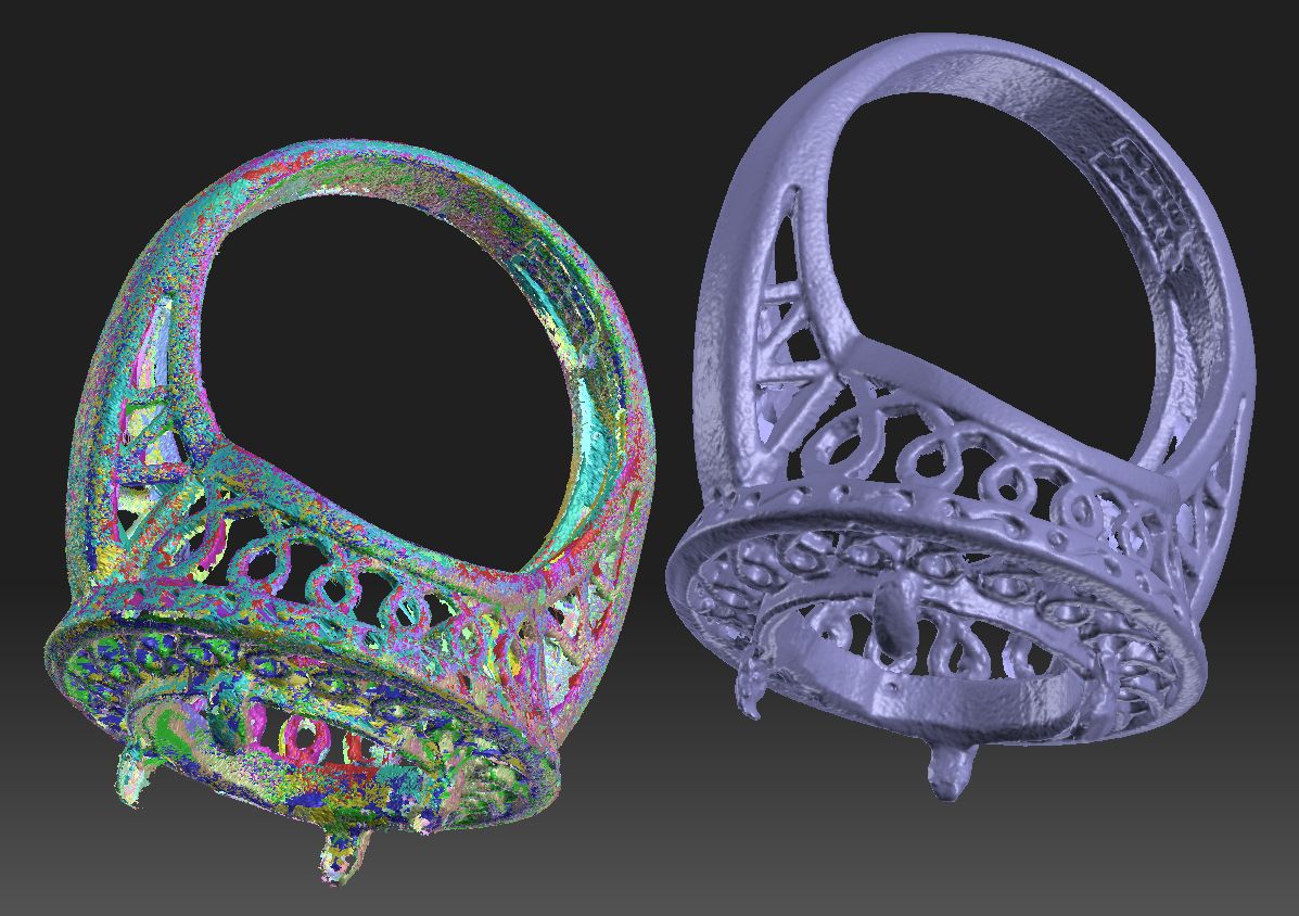

Silver ring scan
Silver ring scan

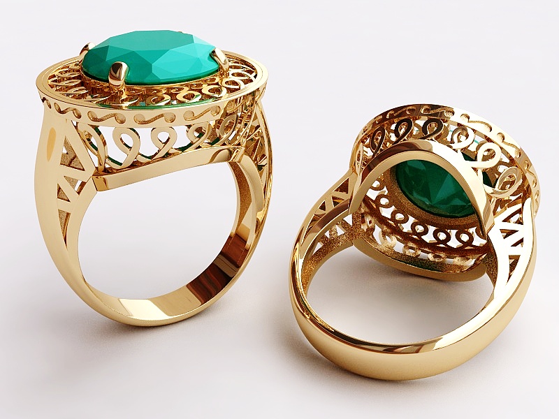

Silver ring to be made of gold
