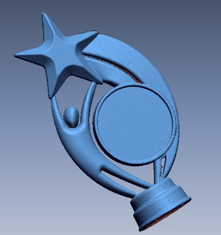

Done by Thunk3D colorful Desktop 3D Scanner Cooper C20 with Accuracy about 0.08mm
