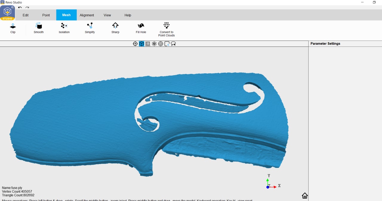

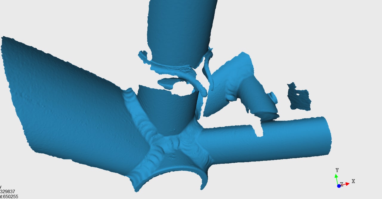

Hi there.
I sold the mini.
For two reasons
1-unable to scan surface I can easily manage with RangeVision: varnished wood
2-handheld scanning needs markers every cm to get a decent tracking. Feature based registration is not working with my objects, which are quite "flat" in most parts. I don't want to attach markers (tons of) to get a final results of less accuracy than with a stationary scanner.
Resolution is good, btw. But I need accuracy also.
I would see an use only if you coat objects, scan small part of the same size of its field of view.
Honestly I was asking too much from a under 1k hand-held scanner. Nevertheless I doubt that the promo pictures are realistic. Scanning a motorbike fender will requires a lot more markers than visible in the picture.
Simply I decided to not invest time in learning how to use it at its best (even af its average..).
See my bicycle details and a bare wood violin part.
Both hand scanned, with enough features to get a decent tracking.
