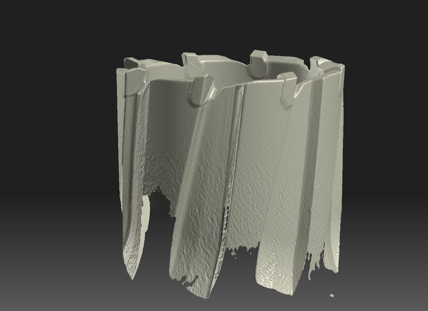

SilverGhost
Posts: 11
Joined: 07 Mar 2017, 07:47
Re: Worm gear reducer
Post by SilverGhost »
here is the fusion result of 8 scans of the crown drill. needed to scan it's teeth to find out what is the angle of sharpening. The setup is nikon d3300 via blackmagic and acer k135i. The roughness on the bottom is the rust
P.S. the diameter of drill is 49мм
