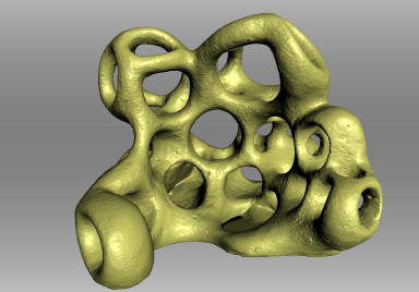

Something is not right. There sounds like a configuration issue. I was using an artec Ava, to scan huge sculptures 3-4m High and wide. So big I had to use markers and scan in multiple pieces and the assembled scans were over 100gb. With a 64 gigabyte computer I'd run out of memory assembling all the scans (This was studio 15 IIRC). However, it never took me more than 20-30 minutes to Align, assemble, decimate or mesh scans. You should reach out to Artec tech support.
