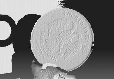

In Russia, one person tried these lenses in front of the projector to scan coins.
That's very good detail. Where the problems show up is when you try to align multiple scans. you will see that they don't completely align, with edges being more of a problem. Keep us posted.

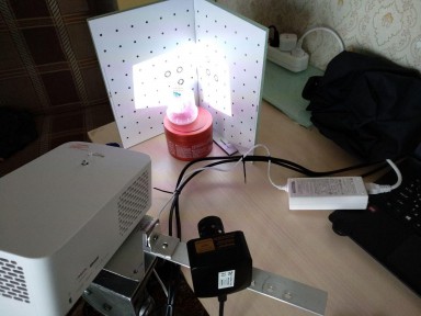

I just tried a +2 lens. I still have not a very good 120mm calibration table with RMS=0,28. When I installed the lens and focused the system on this table my RMS=0.27. It's not perfect, but enough for most objects. Certainly, for a better result, I need a 30mm calibration table.

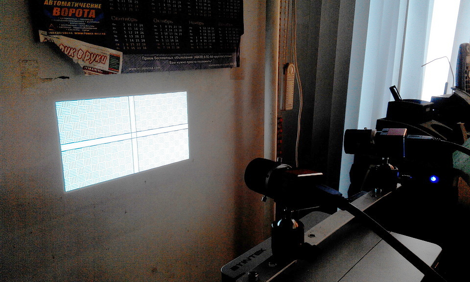

I use an portable LED-DLP projector Byintek UFO R9 (without Android) purchased on Aliexpress (1280 * 800).
LED DLP Byintek UFO R9
The minimum focusing distance is 110mm, while the projection size is about 50x80mm, at a distance of 350mm (shown in the photo) the projection size is 250x150mm
Distance - 350mm, projection size - 250x150mm
