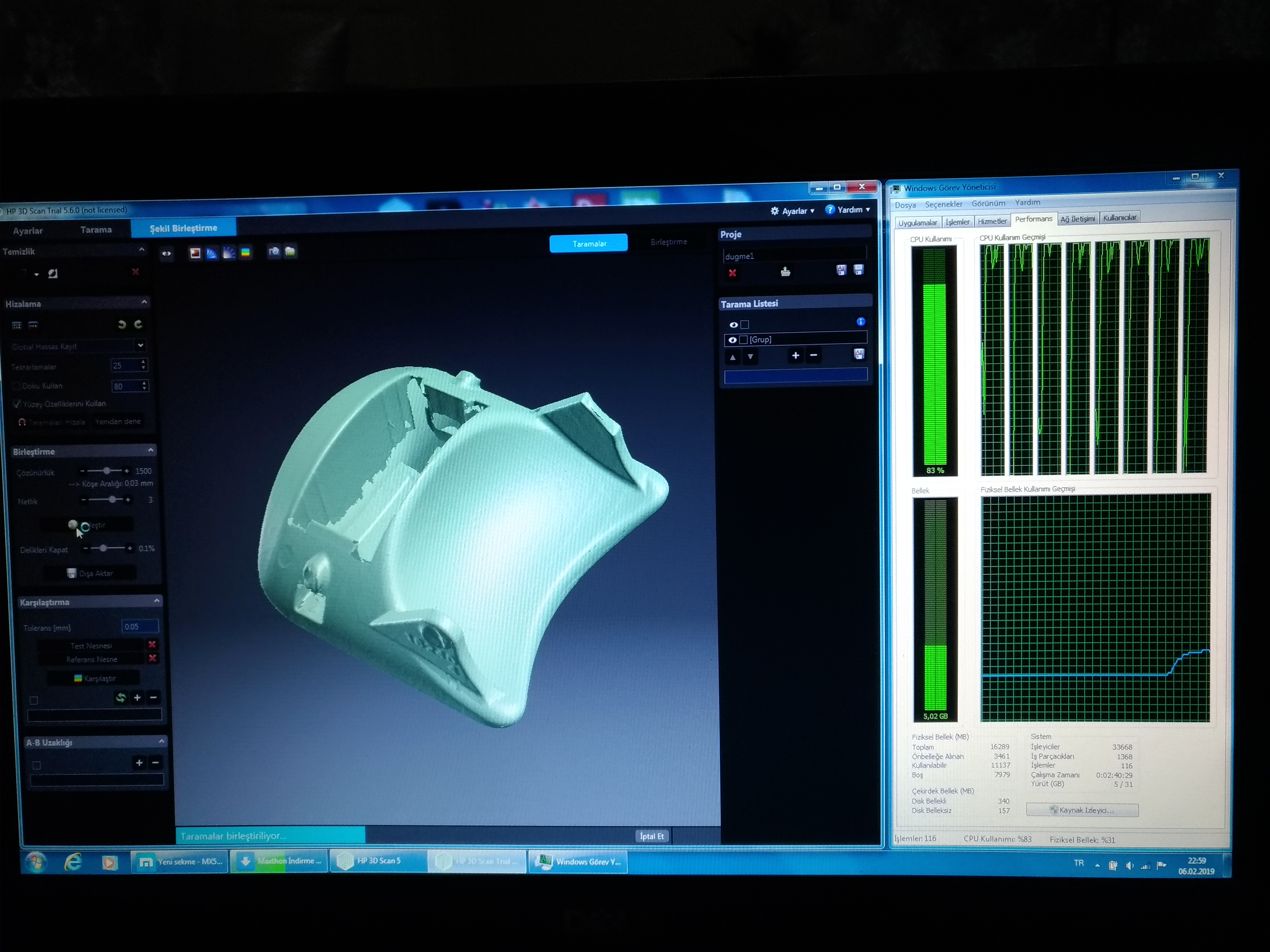

Re: Which processor for fast alignment and fuse operation?
Micr0 is very justified.
I did tests with two computers.
1.System
Dell M4800 i7 4800MQ 250SSD + 1TB HDD, Quadro K2100M, 16GB DDR3 RAM Win7
2 .system
amd ryzen 1800x, asus tuf b450, 250ssd + 1tb hdd, quadro k4000, 16gb ddr4 2400mhz ram win10
2. system better for 3D CAD modeling
1. system faster in alignment and fusion operations,
1. system 60% faster in the same piece of test 8.1min - 13min (global fine registration 55 scans).
now i'm thinking to replace my processor with i7 8700k or i9 9900k, but very expensive. Maybe i7 6700k also think
Wow you’d think the Ryzen core would blow the other right out of the water!!
Have you checked to see if the software is using all 16 threads during processing?

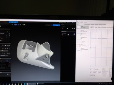

I did a test today and ryzen calculated it faster
. All cores of ryzen were used during the process.
Result: ryzen: 1,42 min, dell m4800: 2,04 min
