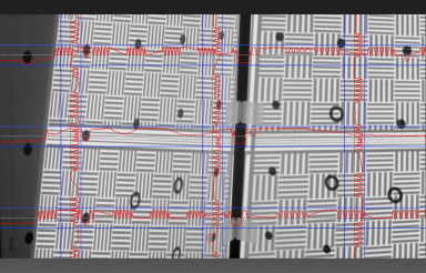

There is so much noise that I am barely able (after dozens of tries) to get DAVID to calibrate, even with longer exposure and gain set to 0.
Here is the best image I was able to produce: Image

Post by Oteck » 07 Apr 2017, 02:51
This is on YUY2 @ 1/8 exposure with the K132 brightness at 57
