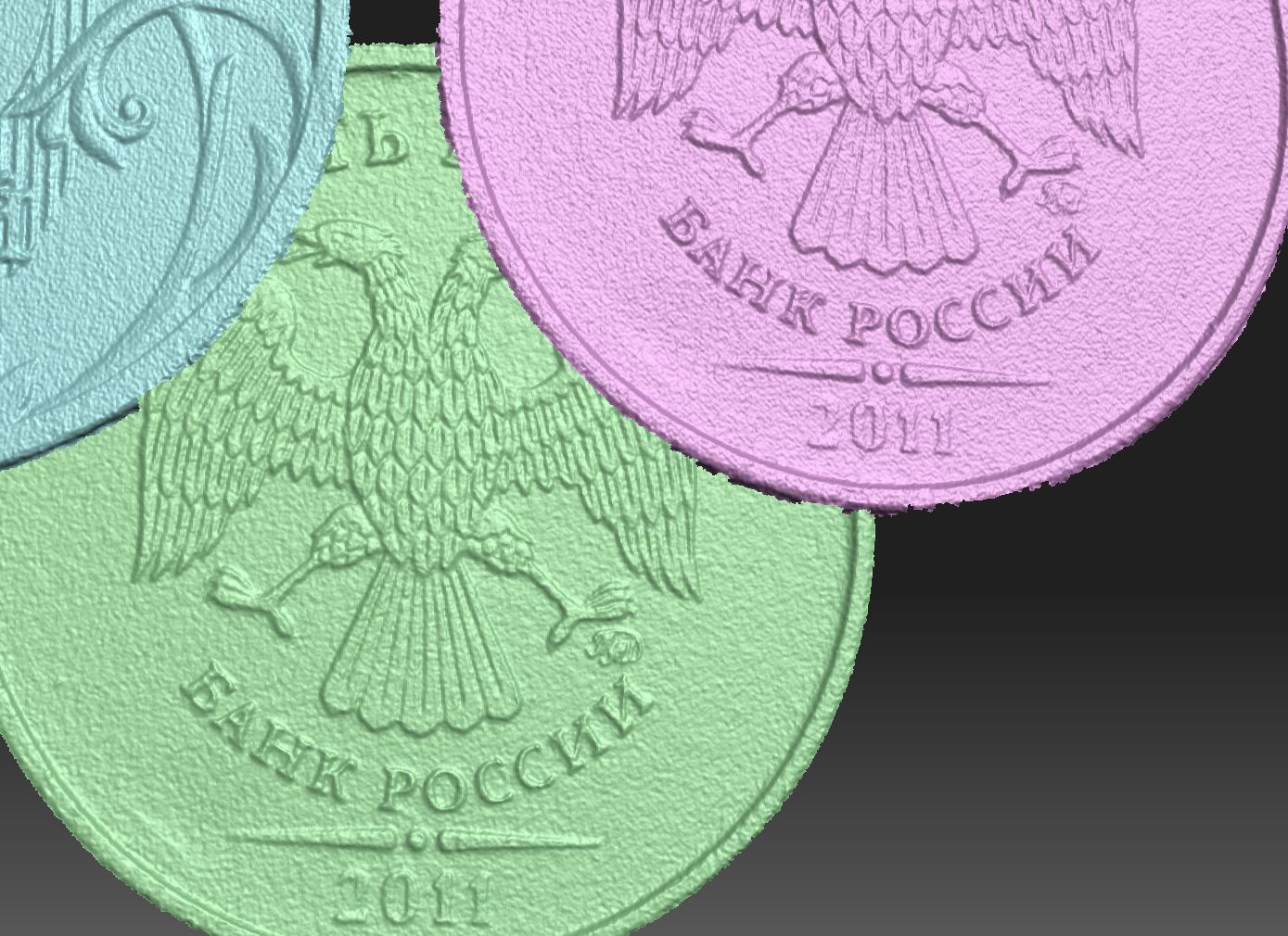

Old cameras are 5MP, new ones are 6.3MP. However, he made scans with a new camera in a resolution of 1600 * 1200 (just so as not to scan the “emptiness” around the coin (it only takes up a small part of the frame))
But this does not affect the resolution of the object, since it has as many camera pixels.
Re: Some of my scans

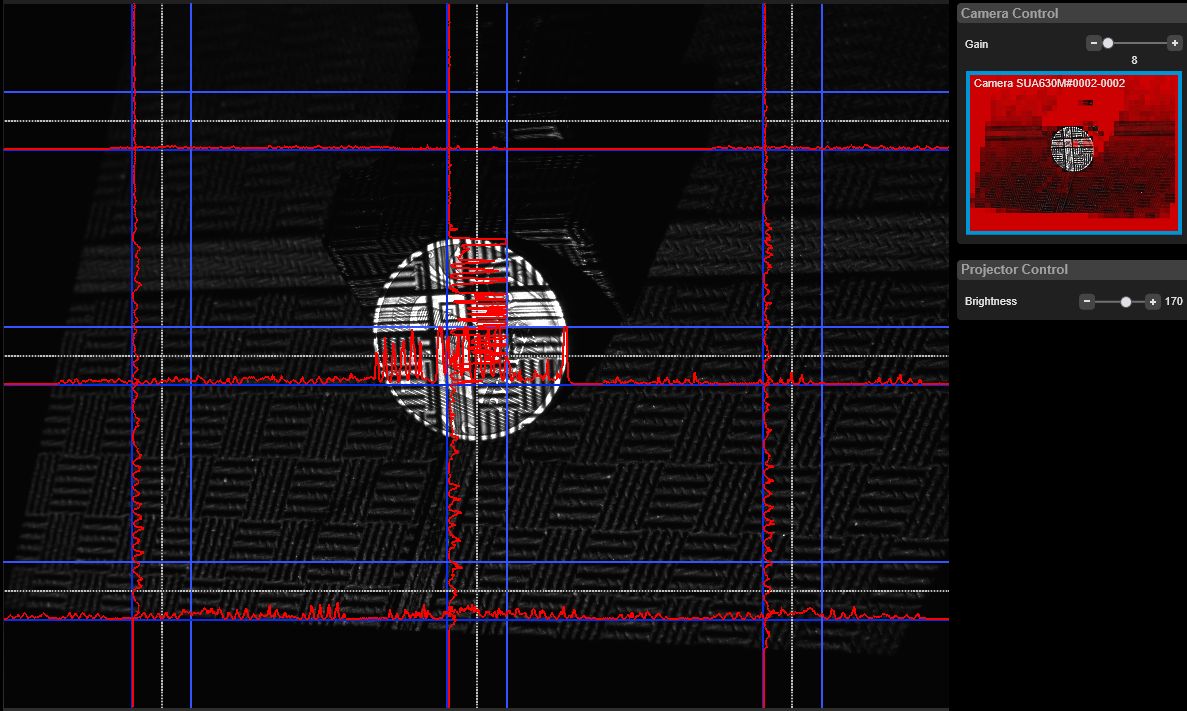

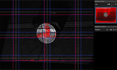

Well, as I expected, you need to get used to every serious camera. It is because of the completely different working settings (and their number, including). As a result, I “defeated” the new camera, having achieved the result, at least - not worse (but much faster). The only thing is that since I, so far, have used the mount bracket from the dismantled right “red” camera as the basis (and because of the slightly larger matrix the field of view has increased), I could only calibrate in 5MP mode (and lower) - I need a camera move closer to the table.
Compared to the old 5MP camera, the new coin (even in exactly the same resolution) took up less space (due to the increased viewing angle). But stable 63fps (in full resolution 6.3MP - 59fps)
General form
General form
Where and what is scanned - now without a hint and can not be determined :-)

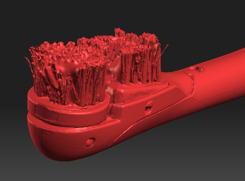

A close-up of the smallest element - the stigma (an excellent test for the scanner, by the way)

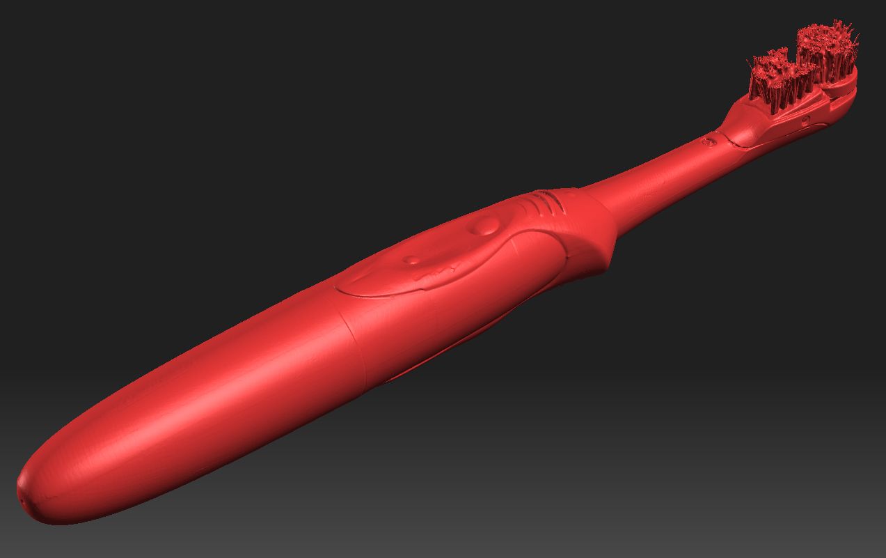

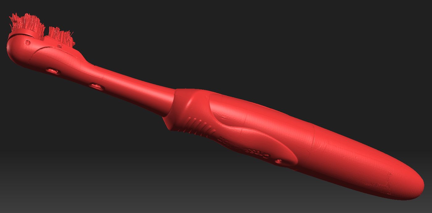

The same 30mm calibration scanned an old toothbrush. There are also “inconsistencies”, especially on the smooth end face of the battery compartment - there is nothing to “catch on” for a good “addition”. Also, the rotary head dangles freely - therefore, when scanning from different angles, it occupied a random position.
OBNRacerMan wrote: 06 Dec 2019, 21:40 The same 30mm calibration scanned an old toothbrush. There are also “inconsistencies”, especially on the smooth end face of the battery compartment - there is nothing to “catch on” for a good “addition”. Also, the rotary head dangles freely - therefore, when scanning from different angles, it occupied a random position.tooth_cleaner_01.jpgtooth_cleaner_02.jpgtooth_cleaner_03.jpg
Nice. Keep us updated.

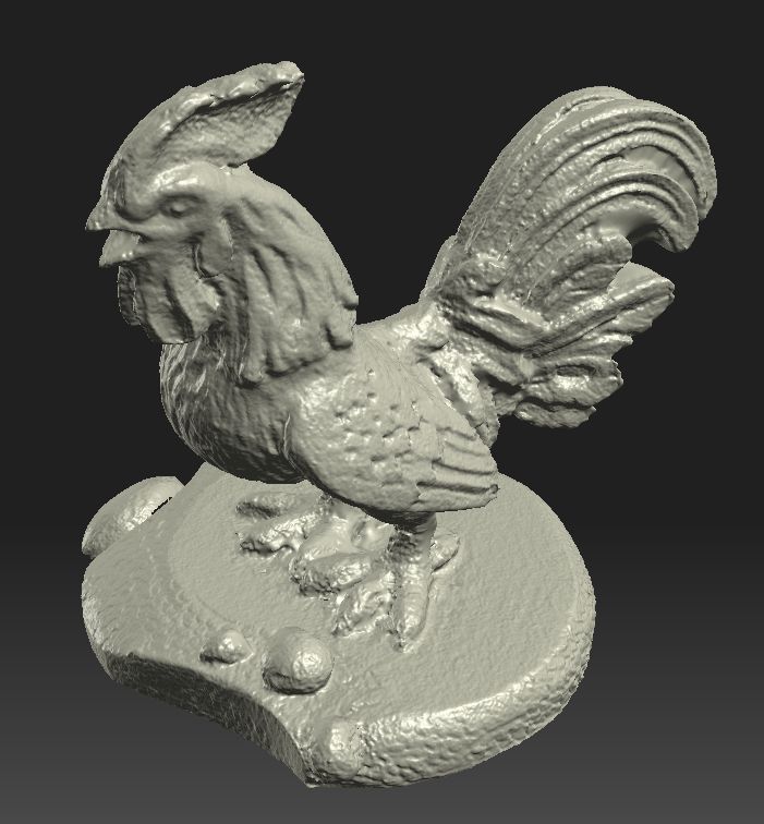

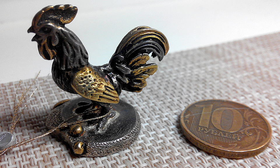

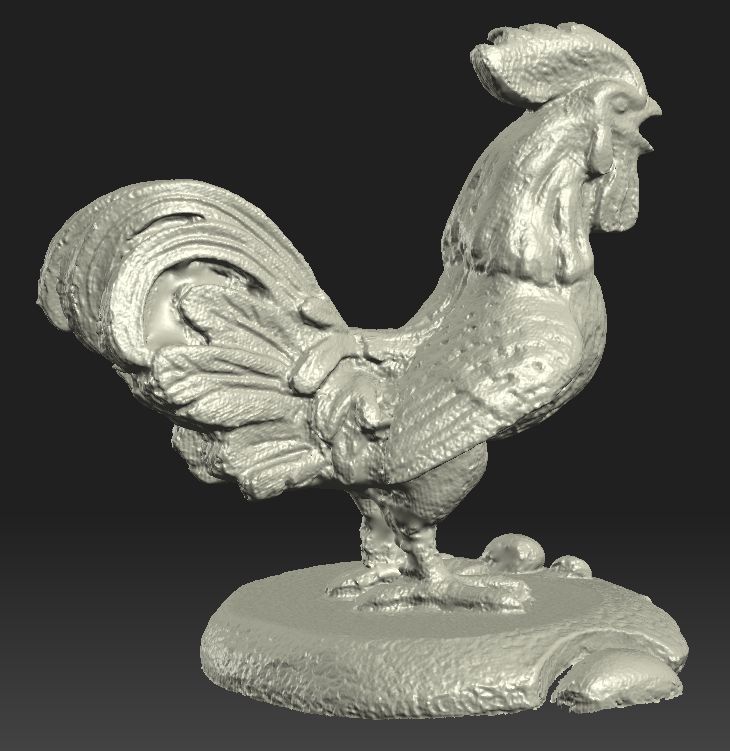

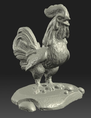

Today (though the scanner was configured for a relatively large, 50mm calibration table), it was able to “capture” a miniature silver souvenir (33mm high, blackened silver and gilding).
Original object
Original object
Old cameras to do this, at least more or less tolerable - I couldn’t get the word "no way."
Final - 1
Final - 1
Final - 2
Final - 2
Final - 3
Final - 3
So, despite the price of the MindVision SUA630M camera - it’s justifying itself for the campaign :D

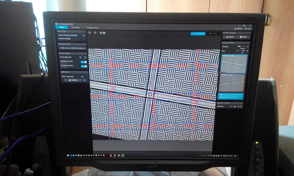

Yes - projector Byintek UFO R9. Camera lens - 12mm (I used them starting with 1/2 "UCMOS3100KPA camera, and the next few cameras with a 1/2.5" matrix (in that case, due to the small matrix, the lenses were closer to 16mm)) In the new camera, the 1/1.8 "matrix - so it turns out about 14mm.
I recall, that these lenses are rated at 12mm with a "big" 2/3 "sensor.
P.S. I also want to note - that cameras with such lenses are well suited to the geometric size of the image displayed by this projector. But if you have to put cameras in front of the projector, then I would look at 8mm lenses.
Projection area
Projection area
Visible area - cameras 1 / 2.5 "+ 12mm lenses

I guess you are tilting the cameras for a specific purpose.
For riducing the artefacts due to the diamond pixels?
