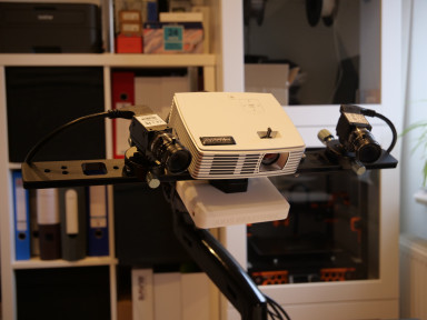

I would like to shortly introduce my scan setup here:
Projector: -Acer K132 (with David Lense)
Camera1 : David Cam 4M + OMRON 3Z4S-LE ML-1214 12mm f1.4
Camera2 : HP 3D Camera Pro + OMRON 3Z4S-LE ML-1214 12mm f1.4
Software: HP 3D Scan Pro v5
Regarding the lenses, I did not really inform myself in advance and bought them on Ebay. But they seem to work fine. Any suggestions for better lenses?
To mount the hardware I have an adjustable monitor arm in use. The cameras are screwed on adjustable panorama heads. The rail is 480mm long. I ordered the parts from Amazon.
The rail is attached to the monitor arm with a 3D printed adapter and the mounting part from the tripod.
I originally had the DAVID SLS-2 package, which I upgraded with the two higher resolution cameras. I kept the projector and the calibration surfaces.

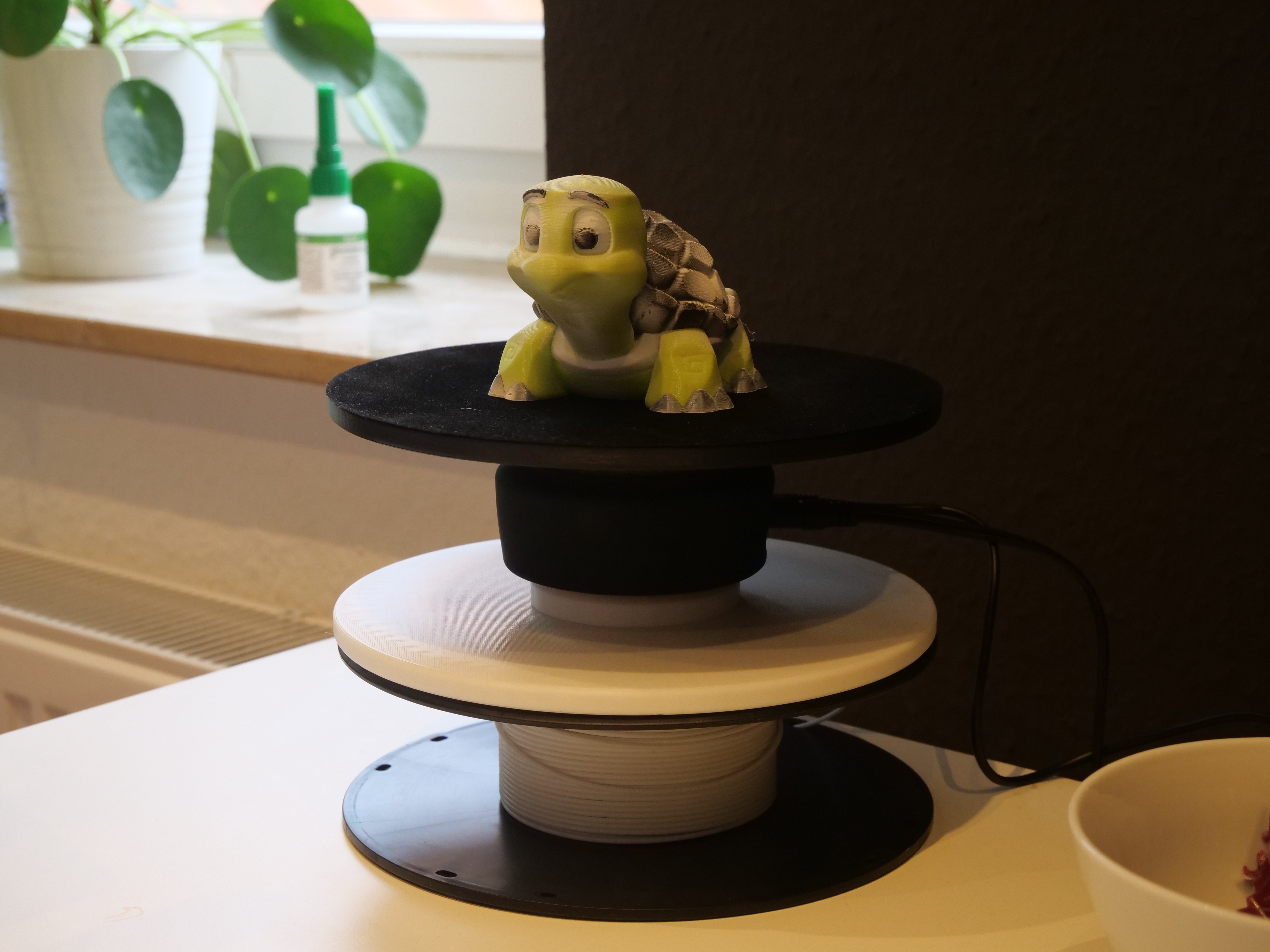

I also built a semi-automatic turntable. The heart of the turntable is a Syrp Genie mini. This device can be used for panoramic shots with the camera and also has a TurnTable mode. I use this in conjunction with the smartphone app and a 3D-printed plate surface. The Syrp has an output for the shutter signal for DSLR cameras. I connected this output to an Arduino and programmed it to send a HID keyboard signal to the PC (F5) to start scanning. In the Syrp app, the number of photos and thus the angle for the turntable can be set.

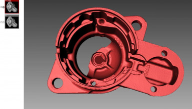

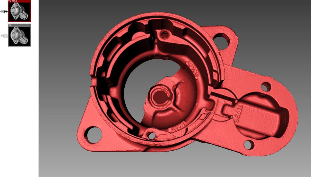

The following scans are done by Erol, a friend from our Telegram group, who is using original DAVID/HP package hardware:

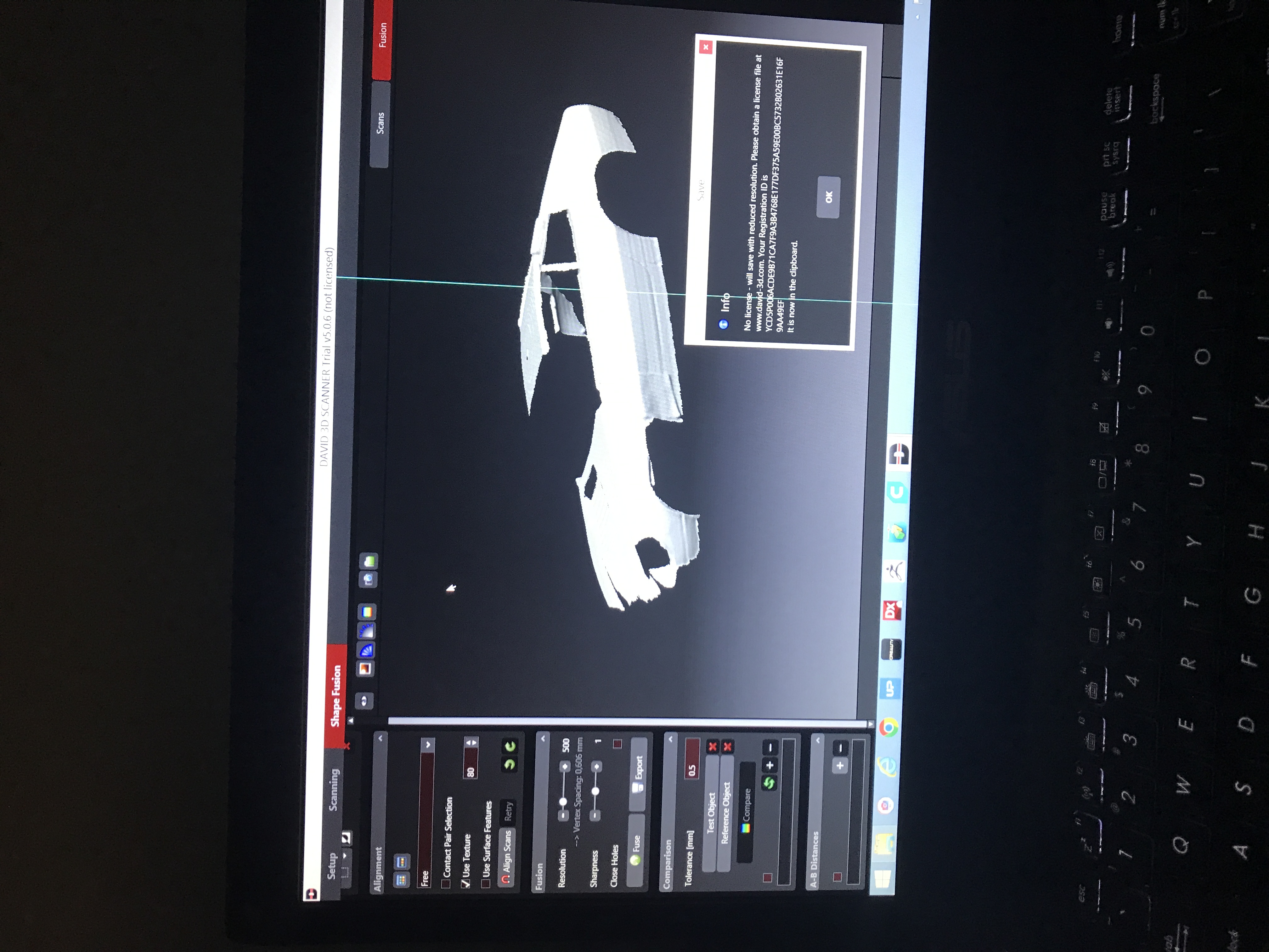

Tenho a necessidade de quem possa me ajudar. Adquiri um Scanner 3D DAVID SLS-3 em 2016 em Miami - USA, e no decorrer dos anos por volta de 2018 a HP adquiriu a Empresa DAVID e o produto passou a ser da HP, HP 3D Structured Light Scanner Pro v5. Sempre acionei o software através de um USB DONGLE, onde agora aparece a mensagem de arquivo corrompido e não tenho mais acesso a minha licença.
Tentei todos os canais de comunicação da HP, mas não obtive resposta de como consigo reativar minha licença.
Alguém poderia me dar um caminho para que eu possa reativar minha licença
