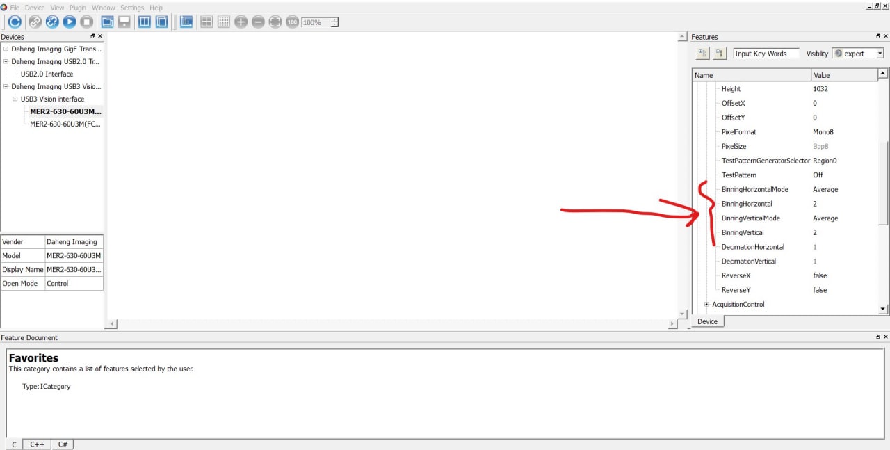

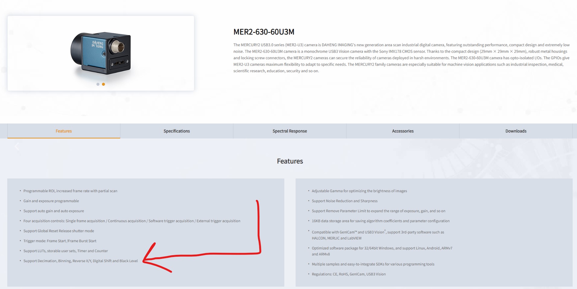

greenskynet wrote: 25 Sep 2022, 08:39 but I recommend Daheng cameras. it has built-in Binning option which is very useful.
Hi. And where does hardware binning come from on Daheng? (I saw only software binning on them, the inclusion of which loads the system very heavily) But Mindvision, BIN2x2 is directly in the drivers. But there are problems there too.
Posts: 127
Re: New scans with FlexScan3d
OBNRacerMan wrote: 25 Sep 2022, 09:17
any Daheng cameras shipped after July 2022 support binning. The elder versions don't have this great option.
by using built-in Binning option, there isn't any extra load on PC and CPU. Also you can achieve so much higher fps and stable frame-rate
Also some members of my group have MindVision cameras and we tested BIN2x2 option on them. it doesn't have correct behavior via both SDK and DirectShow on any software, including HP and FlexScan.
