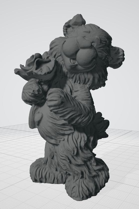

Found another interesting object to scan:
Souvenir "Bear with a rose"
Object height - 70mm
Uploading pictures is, of course, a good way to show the model...
But it is even better when you can safely turn it "in (virtual) hands" :D
All you need to view is a web browser
