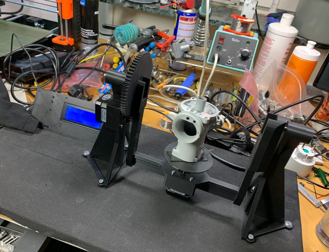

It's alive!
Desk still messy
Desk still messy
After massive problems (broken i2c-controller) with I2C to the display it is now up and running. It does what one expects.
Next case is to make it work with HP3Dscan according to my old setup with the DIY turntable (Arduino/AutoIt).

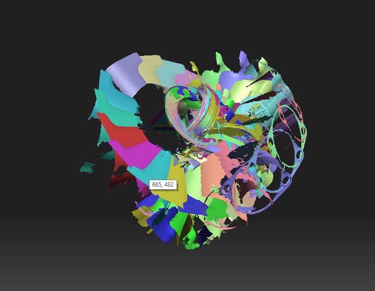

Before alignment
Before alignment

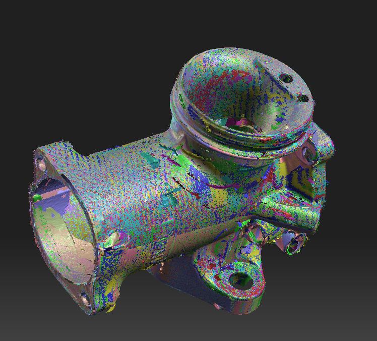

Aligned
Aligned

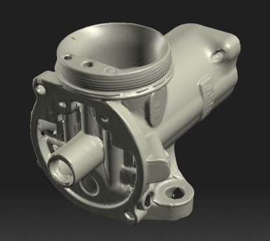

Fused
Fused
