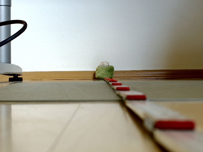

I just screwed the black adapter fully into the camera and the lens fully into the adapter. Then i took an image with a distance of 2m and the closest i can focus to. Here's the result:
Then i unscrewed the black adapter ring by a full turn (moving the lens a bit away from the camera body). And here we go, perfectly sharp image and even a bit of headroom to focus:

Unscrewed another 1/2 turn (now 1.5 turns out) and here we go, perfectly sharp image at 40cm (!) distance. As you can see the distance between camera and lens is crucial to get the focus range right. Even a tiny offset will give you extremely differing results. See 2nd picture for the gap between lens and camera.
@kth
I also got the distance of 8mm on my camera as shown above.
